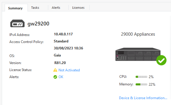

To monitor the RAID status of the storage devices in SmartConsole:
  1. From the left navigation panel, click Gateways & Servers.
  2. In the top pane, select the Security Gateway / Cluster object that represents the appliance.
  3. In the lower pane, on the Summary tab, click Device & License Information.
    Example:

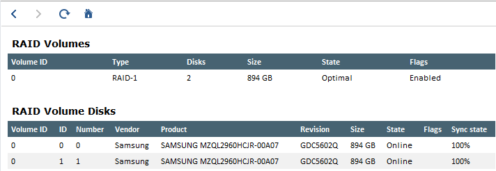

  4. Click RAID Volumes.
    The window shows volume and disk information.
    Example:
