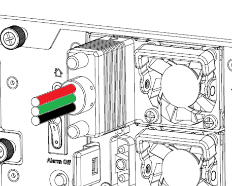

DC Power Connections
When your appliance uses a DC PSU, make sure to follow these instructions.
To connect DC power wires to a DC PSU connector:
  1. Connect the GREEN wire to the ground terminal.
  2. Connect the RED wire to the 36-46/46-72V pin on the DC power source.
  3. Connect the BLACK wire to the return pin on the DC power source.
For further instructions, refer to the Installing and Removing DC Power Supply Units guide.
Important - This product must be powered by a UL Listed DC power source, rated 36-46/46-72Vdc, 35/40A minimum, Tmax=40°C, and the maximum operating altitude of 5000m.
The wire requirements: 8 AWG, 40A minimum, 72V minimum.
