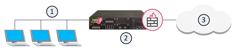

Example diagram
Item |
Description |
1 |
Internal computers |
2 |
Security Gateway configured with Hide NAT |
3 |
External computers and servers on the Internet |
Sample Hide NAT Workflow
Internal computer A (10.10.0.26) sends a packet to an external computer.
The Security Gateway intercepts the packet and translates the source IP address from (10.10.0.26) to 192.0.2.1, and port 11000.
The external computer sends back a packet to 192.0.2.1, to port 11000.
The Security Gateway translates the packet's IP address from 192.0.2.1 to 10.10.0.26 and sends it to internal computer A.
