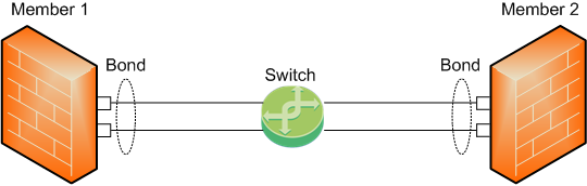

The Sync interface is a Bond of several physical subordinate interfaces.
To work with this topology, you can configure the Bond interface in High Availability or Load Sharing mode.
All physical subordinate interfaces on all Cluster Members connect to the same switch.
In this topology, Cluster Members monitor only the link state of the subordinate interfaces.

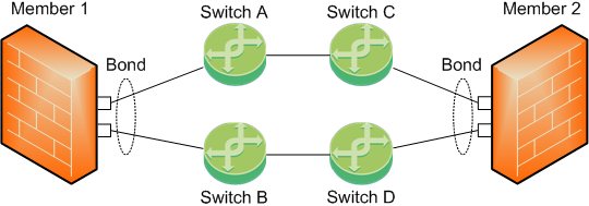

On each Cluster Member, physical subordinate interfaces of the same Bond connect to different switches.
The switches must connect to each other through a cable.

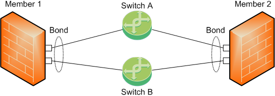

To work with this topology:
You must configure the Bond interface in the Active-Backup mode.
You must not configure the primary subordinate interface explicitly.
The switches do not need to connect to each other through a cable.
In this topology, Cluster Members:
Monitor the link state of the subordinate interfaces.
Monitor the path between the Cluster Members, communicate about their connectivity, and agree on which bond subordinate interface to use.
Send Cluster Control Protocol
Proprietary Check Point protocol that runs between Cluster Members on UDP port 8116, and has the following roles: (1) State Synchronization (Delta Sync), (2) Health checks (state of Cluster Members and of cluster interfaces): Health-status Reports, Cluster-member Probing, State-change Commands, Querying for cluster membership. Note: CCP is located between the Check Point Firewall kernel and the network interface (therefore, only TCPdump should be used for capturing this traffic). Acronym: CCP. (CCP) packets only on the active subordinate interface (there is no CCP broadcast on all the subordinate interfaces). -
Fail over only if all subordinate interfaces are down.
Additional information
If a Cluster Member does not receive CCP packets from other Cluster Members (for example, a cable is disconnected between switches), it sends a dedicated CCP packet to all other Cluster Members.
This dedicated CCP packet includes a map of all available bond subordinate interfaces on that Cluster Member.
When other Cluster Members receive this dedicated CCP packet, they:
Compare the received map of available bond subordinate interfaces to the state of their own bond subordinate interfaces.
Perform bond internal failover accordingly.
Fail over to a specific selected subordinate interface instead of iterating over all available subordinate interfaces.

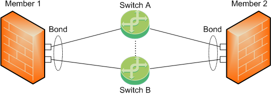

On each Cluster Member, physical subordinate interfaces of the same Bond connect to different pairs of switches.
These pairs of switches connect to each other (chained together).
Send Cluster Control Protocol (CCP) packets only on the active subordinate interface (there is no CCP broadcast on all the subordinate interfaces).
