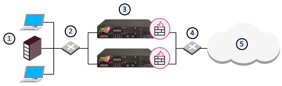

ClusterXL Solution
ClusterXLClosed Cluster of Check Point Security Gateways that work together in a redundant configuration. The ClusterXL both handles the traffic and performs State Synchronization. These Check Point Security Gateways are installed on Gaia OS: (1) ClusterXL supports up to 5 Cluster Members, (2) VRRP Cluster supports up to 2 Cluster Members, (3) VSX VSLS cluster supports up to 13 Cluster Members. Note: In ClusterXL Load Sharing mode, configuring more than 4 Cluster Members significantly decreases the cluster performance due to amount of Delta Sync traffic. is a Check Point software-based clusterClosed Two or more Security Gateways that work together in a redundant configuration - High Availability, or Load Sharing. solution for Security Gateway redundancy and Load SharingClosed A redundant cluster mode, where all Cluster Members process all incoming traffic in parallel. For more information, see "Load Sharing Multicast Mode" and "Load Sharing Unicast Mode". Synonyms: Active/Active, Load Balancing mode. Acronym: LS.. A ClusterXL Security Cluster contains identical Check Point Security Gateways.
Item
Description
1
Internal network
2
Switch for internal network
3
Security Gateways with ClusterXL Software BladeClosed Specific security solution (module): (1) On a Security Gateway, each Software Blade inspects specific characteristics of the traffic (2) On a Management Server, each Software Blade enables different management capabilities.
4
Switch for external networks
5
Internet
