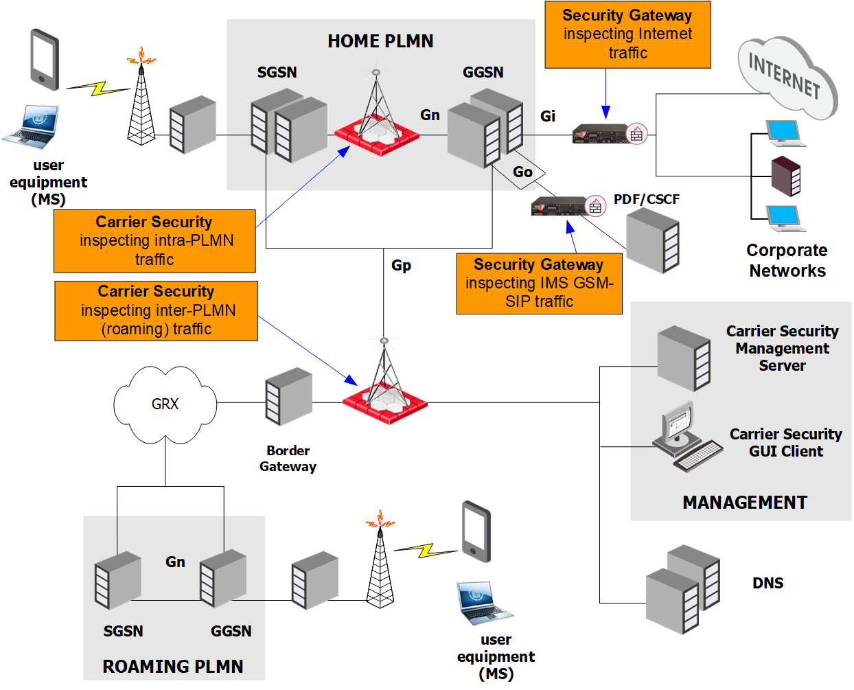

Deploying Carrier Security
For maximum security, a Carrier Security Gateway should be installed at all points in the network where the Home PLMN interfaces with other networks: at Border Gateways (Gp/S8) and Intra-PLMN interfaces (Gn/S5).
Suggested Carrier Security deployment:
In this example, two types of Check Point Gateways are deployed. The protections provided by each are described below:
Carrier Security Gateways
Carrier Security Gateways (Gateways with carrier license) are deployed at these interfaces:
Interface |
Located Between |
Description |
Gp/S8 |
Home PLMN and GRX |
Filters incoming roaming traffic and enforces a |
Gn/S5 |
GGSNs and the SSGNs in the HomePLMN |
Filters traffic between the Home PLMN GSNs, protecting them from malicious or erroneous traffic. |
