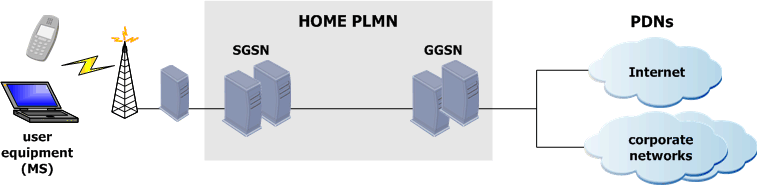

GSN
GPRS Support Node. or xGSN (GPRS Support Node) - a generic term that refers to both SGSNs and GGSNs.
SGSN
Serving GSN - a GPRS Support Node. (Serving GPRS Support Node) - sends and receives data from mobile stations, and maintains information about their location. -
GGSN
Gateway GSN (GPRS Support Node). (Gateway GPRS Support Node) - acts as mediator between encapsulated GTP
GPRS Tunnel Protocol. traffic on the PLMN, and packetized IP traffic on the Internet and other PDNs.

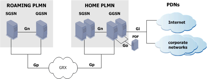

Gi
Reference point between GPRS and an external packet data network. interface - connects GGSN to an external PDN. -
Gn
Interface between two GSNs within the same PLMN. interface - connects xGSNs on same PLMN. -
Go interface - connects a GGSN to a Policy Decision Function (PDF).
Gp
Interface between two GSNs in different PLMNs. The Gp interface allows support of GPRS network services across areas served by the co-operating GPRS PLMNs. interface - connects xGSNs on different PLMNs.

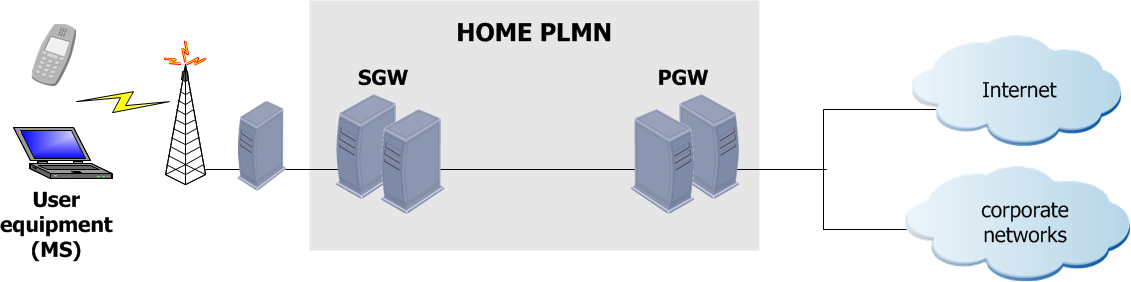

Basic Components of LTE Networks
SGW
Serving Gateway - a LTE support node. - The serving gateway, which handles routes and forwards data packets and eNodeB handovers. -
PGW
Packet Data Network Gateway - an LTE support node. - Packet Data Network Gateway, the exit and entry point for traffic to user equipment. -

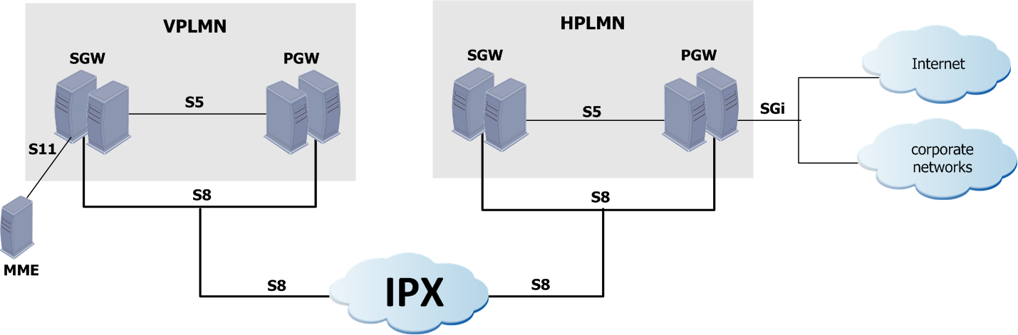

S5 and S8 are the main interfaces used for roaming. S5 is used in the Home Public Land Mobile Network (HPLMN) and S8 in the Visiting Public Land Mobile Network (VPLMN
Visited Public Land Mobile Network - the network where the MS is currently located.).
SGi interface - connects PGW to an external PDN.
S5 interface - connects SGW and PGW on same PLMN.
S8 interface - connects SGW on the VPLMN with the PGW at the HPLMN.
S11 interface - connects the MME to the SGW.
