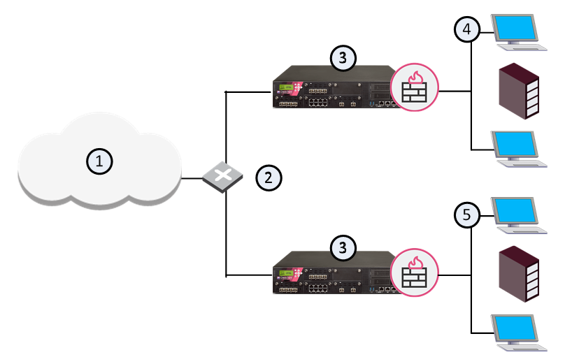

Security Gateway Deployment on a Physical Network
In large physical network deployments, multiple Check Point security products, such as Security Gateways, are deployed to protect network segments.
Item
Description
1
Internet
2
Router
3
Security Gateways
4
Network 1
5
Network 2
Each Security GatewayClosed Dedicated Check Point server that runs Check Point software to inspect traffic and enforce Security Policies for connected network resources. physically connects to its own internal protected network and to a router for access to other internal networks and the Internet.

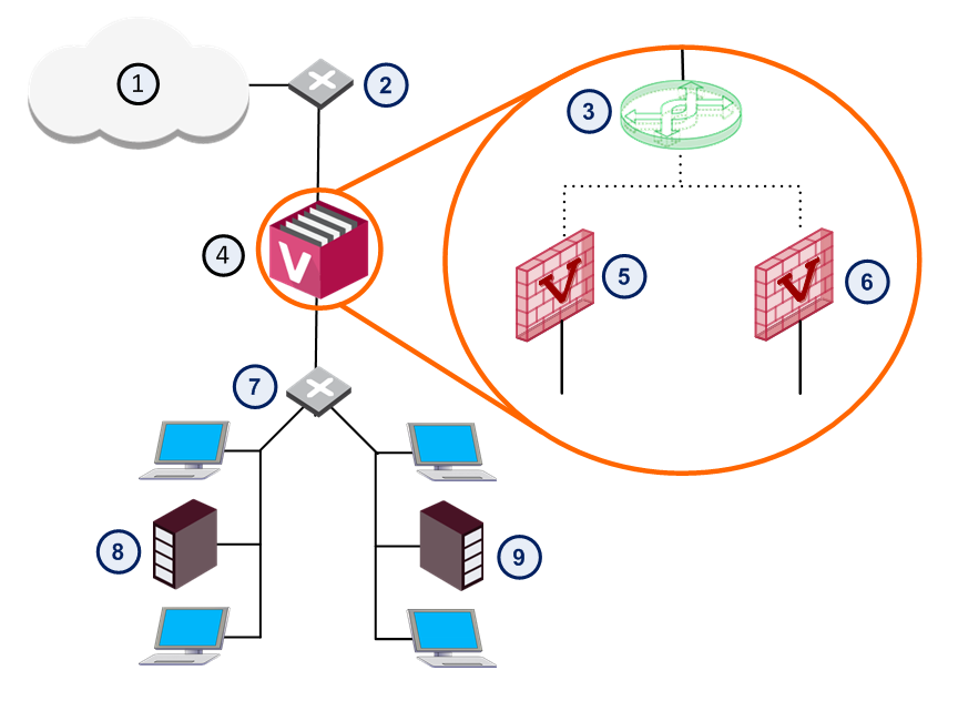

Physical Internal Interface for Each Virtual System
In a basic VSX configuration, Virtual Systems connect directly to protected internal networks through physical interfaces on the VSX GatewayClosed Physical server that hosts VSX virtual networks, including all Virtual Devices that provide the functionality of physical network devices. It holds at least one Virtual System, which is called VS0.. A Virtual SwitchClosed Virtual Device on a VSX Gateway or VSX Cluster Member that functions as a physical switch. Acronym: VSW. connects between internal networks, and to the Internet. This deployment is suitable for protecting a small, fixed quantity of internal networks.
The main disadvantage of this deployment is that each protected network requires its own dedicated physical interface on the VSX Gateway. Obviously, this deployment is not suitable for networks that require many Virtual Systems.
Item
Description
Item
Description
1
Internet
6
Virtual SystemClosed Virtual Device on a VSX Gateway or VSX Cluster Member that implements the functionality of a Security Gateway. Acronym: VS. 2
2
Router
7
Switch
3
Virtual Switch
8
Network 1
4
VSX Gateway
9
Network 2
5
Virtual System 1
Warp LinkClosed Logical interface that is created automatically in a VSX topology between: (1) Virtual System and Virtual Switch (2) Virtual System and Virtual Router. Acronym: WRP.

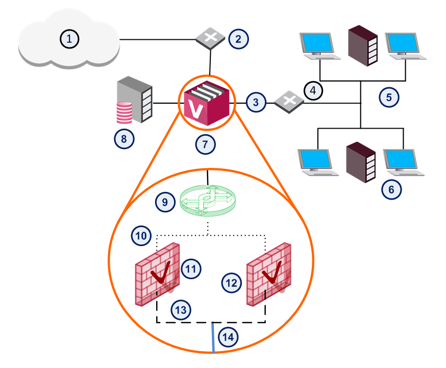

Virtual Systems with Internal VLAN Interfaces
In this deployment example, Virtual Systems connect to internal protected networks through VLAN interfaces. The VSX Gateway connects to a VLAN switch with an 802.1q VLAN trunk, which is an aggregate of all VLANs passing through it.
This deployment option is appropriate for environments where many Virtual Systems protect many internal networks with one VSX Gateway or clusterClosed Two or more Security Gateways that work together in a redundant configuration - High Availability, or Load Sharing.. VLANs provide scalability and granularity, to provision more Virtual Systems and protected networks quickly, without changing the existing IP address structure.
Item
Description
Item
Description
1
Internet
8
Management ServerClosed Check Point Single-Domain Security Management Server or a Multi-Domain Security Management Server.
2
Router
9
Virtual Switch
3
Physical interface
10
Warp interface
4
VLAN Switch
11
Virtual System 1
5
Network 1
12
Virtual System 2
6
Network 2
13
VLAN Interface
7
VSX Gateway
14
VLAN Trunk

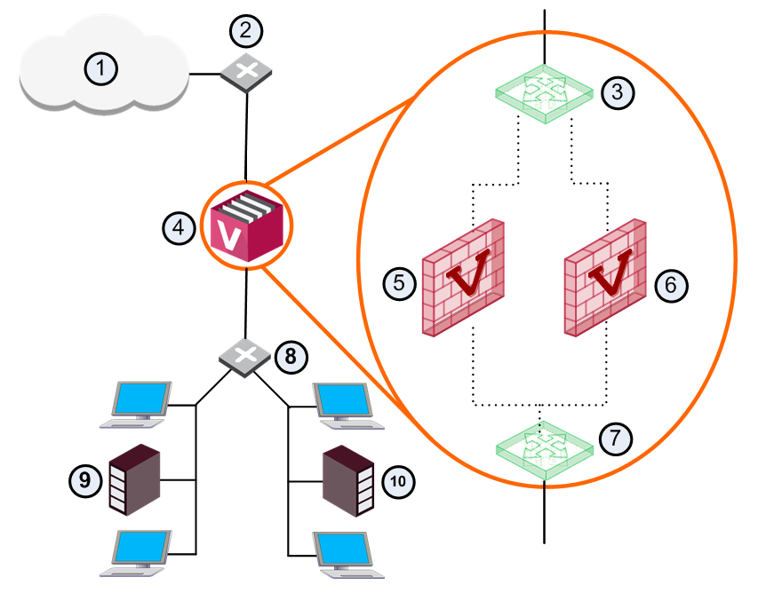

Internal Virtual Router with Source-Based Routing
Important - Virtual Routers are not supported (Known Limitation 01413513).
This deployment scenario enables Virtual Systems to connect to protected networks using one physical interface without VLAN technology. The Virtual RouterClosed Virtual Device on a VSX Gateway or VSX Cluster Member that functions as a physical router. Acronym: VR. uses source-based routing rules to forward traffic to the appropriate Virtual System based on its source IP address.
In a VSX deployment with each Virtual System connected to one Virtual Router: You can configure the Virtual Router to use source-based routing rules, to forward traffic to the appropriate Virtual System, based on the source IP address.
Item
Description
Item
Description
1
Internet
7
Virtual Router
2
Router
8
Router
3
Virtual Switch
9
Network 1
4
VSX Gateway
10
Network 2
5
VS 1
Warp link
6
VS 2
Notes for this scenario:
  • Each Virtual System uses a public IP address to connect to the Virtual Switch.
  • Each local network connected to a Virtual Router uses private IP addresses.
  • This deployment does not support overlapping IP addresses.
  • Anti-Spoofing protection does function for packets originating from the shared internal interface. We recommend that you configure the internal physical router to perform Anti-Spoofing protection.
VSX Routing Concepts provides a detailed discussion of routing options in VSX environments.

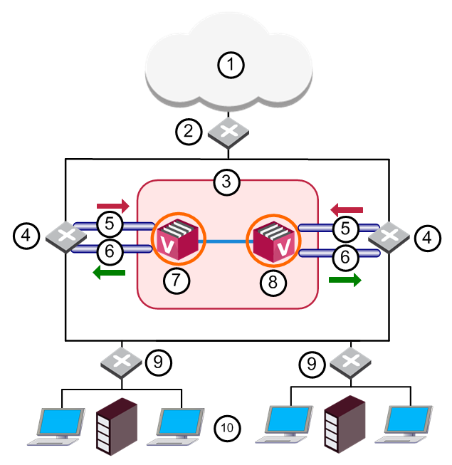

Active/Standby Bridge Mode
The Active/Standby Bridge Mode provides path redundancy and loop prevention, while offering seamless support for Virtual System Load SharingClosed VSX Cluster technology that assigns Virtual System traffic to different Active Cluster Members. Acronym: VSLS. and overcoming many Spanning Tree Protocol (STP) Bridge mode limitations.
Important - R80.20SP does not support VSLS (Known Limitation MBS-5288).
VLAN Shared Interface Deployment - Active/Standby Bridge Mode
In this scenario, each individual member connects to pair of redundant switches via a VLAN trunk. All Virtual Systems in a given member share the same VLAN trunk.
Item
Description
Item
Description
1
Internet
9
VS 3 Backup
2
Redundant switches (external)
10
Redundant switches (internal)
3
VSX Cluster
11
VLAN Switch
4
Member 1
12
Internal Networks
5
Member 2
Sync Network
6
Virtual Systems in Bridge Mode
Physical Interface
7
VS 1 Active
VLAN Trunk
8
VS 2 Standby
When using the Active/Standby Bridge Mode in a High Availability deployment, VSX directs traffic to VSX Cluster Members according to predefined priorities and state of VSX Cluster Members. In VSLS deployments, VSX distributes the traffic load amongst VSX Cluster Members according to a set of predefined preferences.
This deployment scenario is appropriate for very large enterprises.

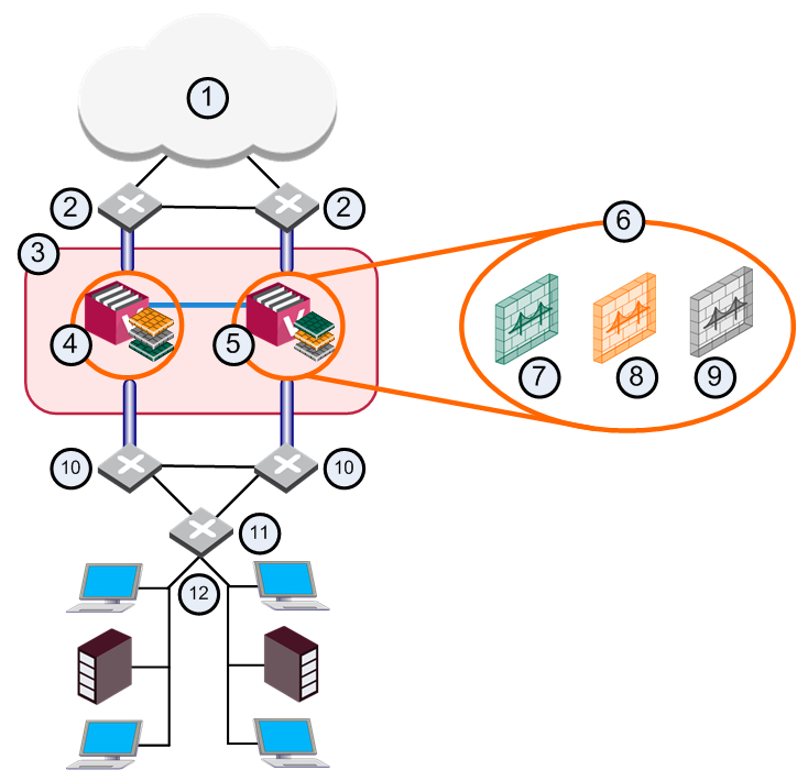

A three layer hierarchical model is appropriate for large, high-traffic network environments. It contains a mixture of components as described below:
  1. A core network, comprised of high-speed backbone switches directs traffic to and from the Internet and other external networks.
  2. A distribution layer, comprised of routers, provides connectivity between the core and the access layer.
  3. An access layer, comprised of redundant LAN switches, forwards traffic to and from internal networks.
Use Active/Standby Bridge Mode with VSX to enforce the security policyClosed Collection of rules that control network traffic and enforce organization guidelines for data protection and access to resources with packet inspection. over the distribution layer.
Item
Description
Item
Description
1
Internet
8
Member 2
2
Core Network Backbone switch
9
LAN switches
3
VSX Cluster
10
Internal Networks
4
Router
Sync Network
5
VLAN 10
Physical Interface
6
VLAN 20
VLAN Trunk
7
Member 1
The routers direct external, "dirty" traffic (typically from the Internet) to the appropriate Virtual System via a segregated VLAN. Filtered, "clean" traffic exits the Virtual System through a separate segregated VLAN back to the routers and on to internal destinations.
