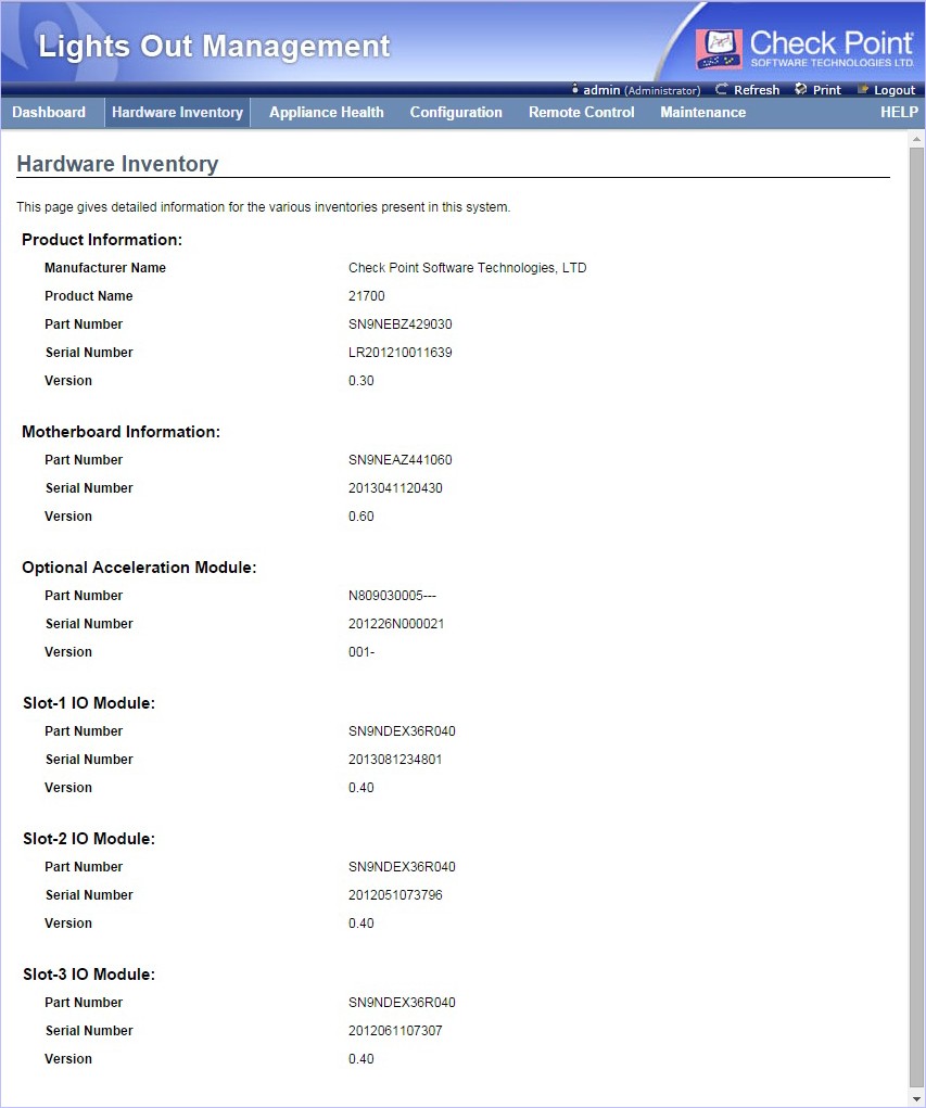

Viewing Hardware Information
The Hardware Inventory window shows information about the appliance and hardware components. This information includes:
  • Product name
  • Serial number
  • Hardware revision
  • Manufacturer name
Each component installed in the machine shows another node with this information:
  • Part number
  • Serial number
  • Version (revision)
To show the hardware information:
From the menu bar, click Hardware Inventory.
Note - This example is from the 21700 appliance model. Different platforms may show less information.
