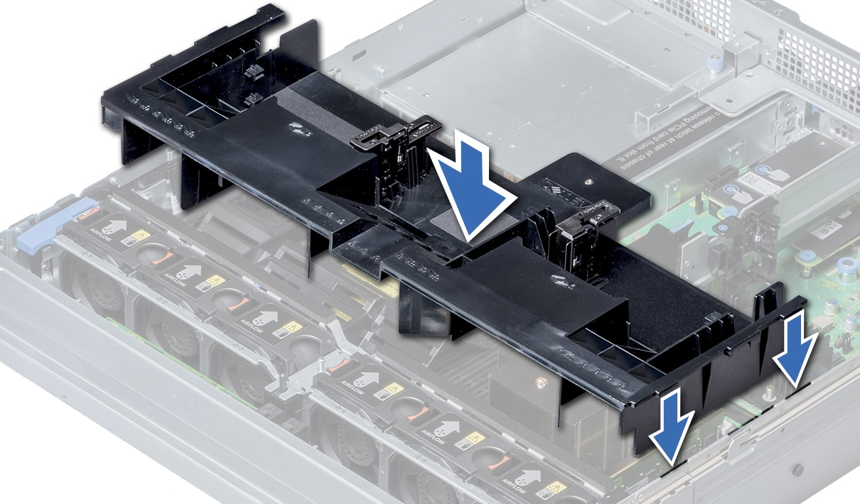

Installing the Cooling Air Shroud
  1. Align the tabs on the air shroud with the slots on the appliance.
  2. Lower the air shroud into the appliance until it is firmly seated.
Note - When firmly seated, the memory socket numbers marked on the air shroud will align with the respective memory sockets.
