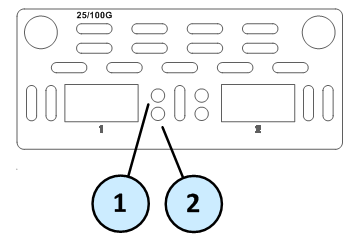

25/100 Gb Line Card (QSFP28)
Front Panel
