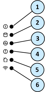

1 |
System power |
2 |
Storage device activity |
3 |
Power supply status |
4 |
Alert |
5 |
Location beacon |
Note - Turn off the Location beacon LED the same way you turned it on |
6 |
WiFi |
Not supported

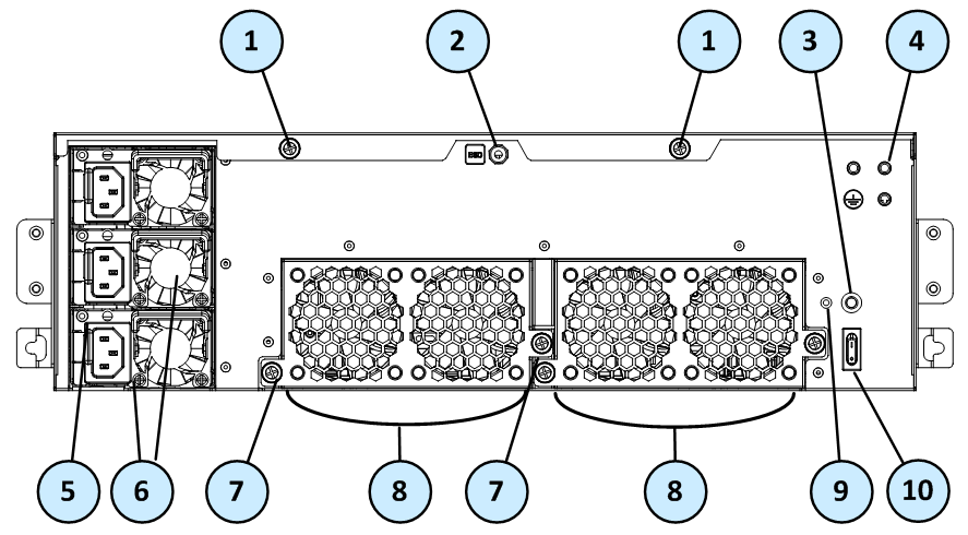

The line drawing shows the rear panel elements in the 26000 appliance.
Item |
Component |
Description |
1 |
Cover screws |
Loosen screws to remove the cover of the appliance. |
2 |
ESD grounding point |
When servicing the appliance, connect an ESD strap to this point. |
3 |
Alarm Off button for power supply units |
If a power supply cable is not connected to the outlet, an alarm sounds continuously. Press this button to turn off the alarm. Note that this button is functional immediately after powering up the appliance. |
4 |
Grounding lugs |
Used to connect grounding. |
5 |
LED indicator for each power supply unit |
6 |
Power supply units |
Three power supplies that you can hot swap. Each power supply unit connects to an electric outlet. You can use the cable restraints to avoid accidental removal of the power supply cable. The PSUs are numbered from top to bottom in the OS as Power Supply #1 (top), Power Supply #2 (middle), and Power Supply #3 (bottom). See also PSU Configuration and Monitoring. |
7 |
Thumb screws for cooling fan unit |
Loosen screws to remove cooling fan unit from the appliance. |
8 |
Cooling fan units |
Numbered from right to left: |
9 |
Location LED |
Note - Turn off the Location LED the same way you turned it on |
10 |
Main power switch |
When the appliance is turned off, turns the appliance on. When the appliance is turned on, pressing and releasing the switch will start an orderly shutdown process. Alternatively, holding the switch for 4 seconds will force a machine shut down. |

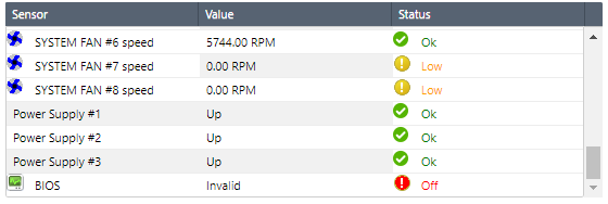

When checking the hardware sensors in the Gaia WebUI or CLI, note that the cooling fans use a different naming convention.
Use the below table to identify each of the 8 fans.
WebUI |
CLI |
System Fan #1 |
System Fan 1 Inside |
System Fan #2 |
System Fan 2 Inside |
System Fan #3 |
System Fan 3 Inside |
System Fan #4 |
System Fan 4 Inside |
System Fan #5 |
System Fan 1 Outside |
System Fan #6 |
System Fan 2 Outside |
System Fan #7 |
System Fan 3 Outside |
System Fan #8 |
System Fan 4 Outside |

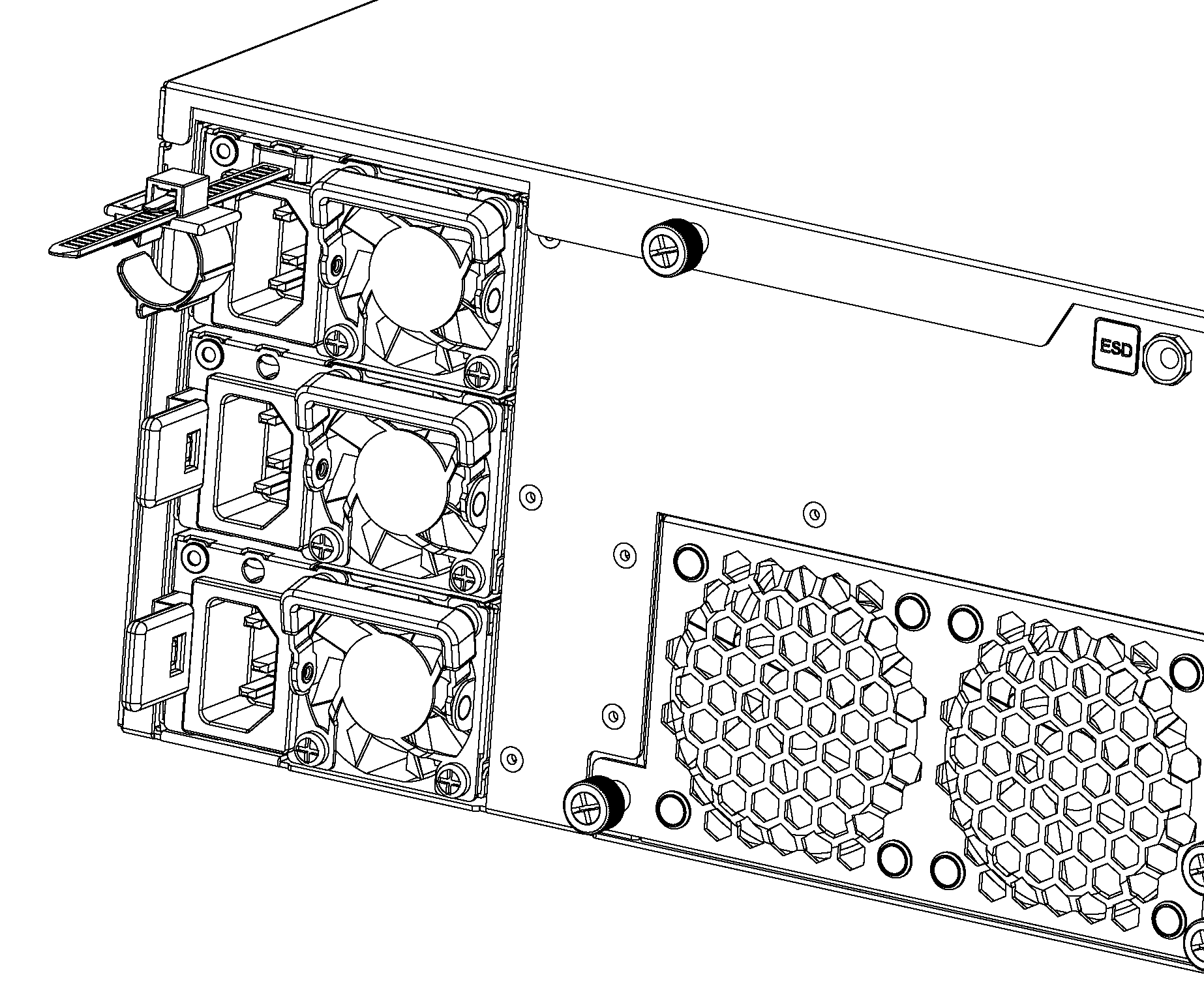

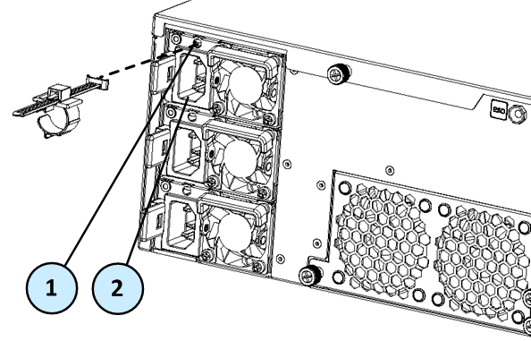

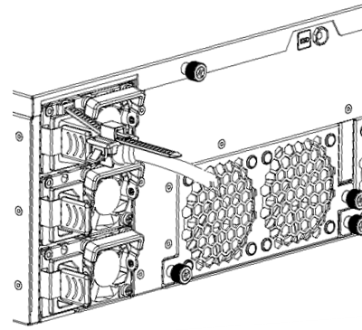

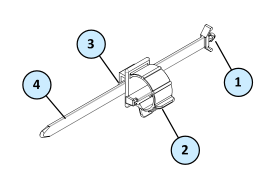

You can use the power cable restraint to prevent accidental removal of the power cable.
Item |
Description |
1 |
Restraint anchor |
2 |
Cable loop |
3 |
Restraint strip tab |
4 |
Restraint strip |
Item |
Description |
1 |
Restraint strip slot |
2 |
Power supply inlet |
To install the power cable restraint:

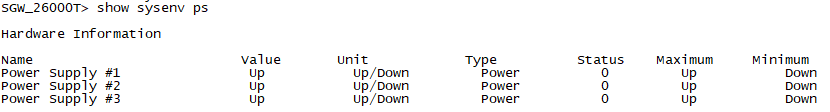

To monitor the PSUs through the CLI:
show sysenv ps
Sample output for a 26000 Turbo appliance:
Where:
Column |
Description |
Power Supply #1 - The PSU in the top PSU slot. Power Supply #2 - The PSU in the middle PSU slot. Power Supply #3- The PSU in the bottom PSU slot. |
Up - The PSU slot contains a PSU is up. Down - The PSU slot contains a PSU and it is not connected to a power source. Empty - There is nothing in the PSU slot. Dummy - The PSU slot contains a dummy filler (only supported for 1 PSU slot in 26000 Base/Plus. |
Up/Down - The type of measure unit used for PSUs is either Up or Down. |
Power - The type of sensor is power supply. |
0 - Denotes no problems found. 1 - Denotes an error. |
Denotes the maximum and minimum thresholds. For PSUs they are only measured as Up and Down. |
