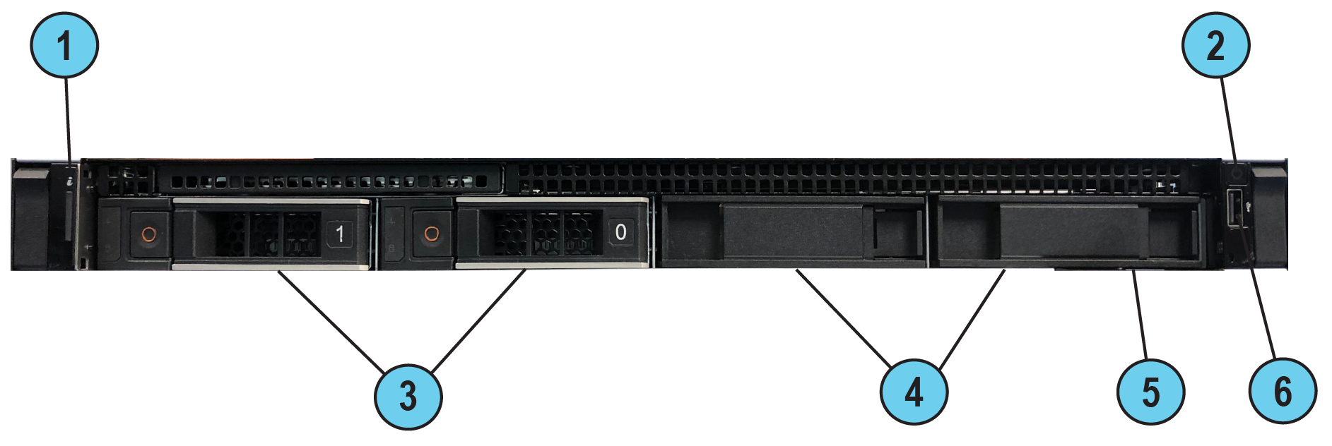

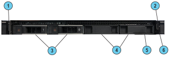

Smart-1 625 Front Panel
Item
Component
Icon
Description
1
System notification LED indicator
Off - Indicates that the appliance is turned on and the system is healthy.
Blinking amber - Indicates that the system is experiencing a fault. Check the System Event Log, see the /var/log/messages files or run the dmesgcommand from Expert mode. For more information about error messages, contact Check Point Support.
2
Power-on indicator, Power button
Lets you know the power status of the system. The power-on indicator glows when the system power is on. The power button controls the power supply output to the system.
3
Storage device slots
Smart-1 625 supports 2 drives. See Storage Devices and Smart-1 625 Installing and Removing Storage Devices.
4
Disk blanks
The disk blanks cover the empty disk slots.
5
Service tag
The service tag contains the MAC address, serial number, and the appliance model. The service tag is a slide-out label panel.
6
USB connector
Let you connect a USB device to the system. The port is USB 2.0-compliant.

Numbering of the Disk Slots on the Smart-1 625 Front Panel:
Slot 0
Slot 1
Slot 2
Slot 3
Disk Disk Empty Empty
Note - Only Slot 0 and Slot 1 are supported in Smart-1 625.
Do not install a disk in Slot 2 or Slot 3.
If you do so, your appliance will show this error:
Disk slot occupation mismatch!!
Only use of slot 0 and 1 is supported.

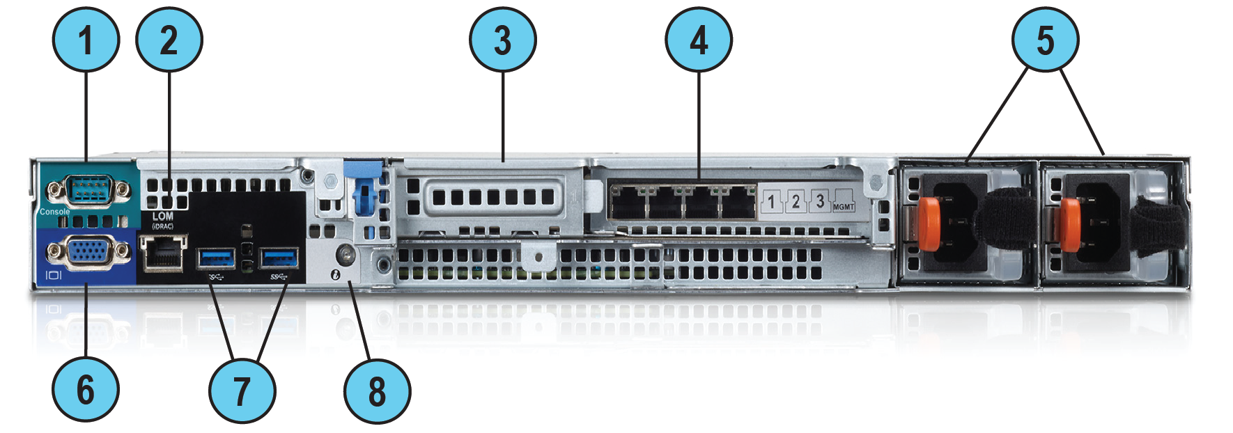

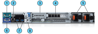

Smart-1 625 Rear Panel
Item
Component
Description
1
Serial console port
Enables you to connect a serial device to the appliance.
2
LOM (iDRAC)
Enables LOM (iDRAC) management. For more information, see sk122914.
3
PCIe expansion slot
The expansion slot enables you to connect a PCI Express expansion card. For more information on the expansion cards that are supported on your appliance, see Smart-1 625 Installing and Removing Expansion Line Cards.
4
Integrated network card
4 Ethernet ports:
  • The appliance connects to the network (Ethernet ports 1, 2, and 3). See Integrated NIC LEDs.
  • Manage the appliance (MGMT port).
5
Power supply units
For more information about the PSU configurations, see Smart-1 625 Installing and Removing AC Power Supply Units.
6
VGA port
Enables you to connect a display device to the appliance.
7
USB 3.0 ports
These USB ports are 9-pin and USB 3.0 compliant. The ports enable you to connect USB devices to the appliance.
8
