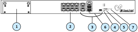

Front Panel
Front Panel Ports
Front Panel System LEDs
System power, storage device activity, power supply status, alert, and location.

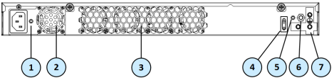

Using the Power Cable Restraint Strip
You can use the power cable restraint to prevent accidental removal of the power cable.
Item |
Description |
1 |
Restraint anchor |
2 |
Cable loop |
3 |
Restraint strip tab |
4 |
Restraint strip |
To install the power cable restraint strip:
If a power cable is connected to the power supply inlet, disconnect it.
Unscrew the screw directly above the power supply inlet.
Make sure the cable loop on the restraint strip faces the power supply inlet.
Insert the restraint strip anchor into the slot and screw it in until it locks.
Connect the power cable to the power supply inlet.
Move the cable loop on the restraint strip.
Move the cable loop until you can put it around the power cable.
Insert the open side of the cable loop into the loop slot until it is tight against the power cable.
Make sure the cable loop is secured and the power cable cannot be removed.
