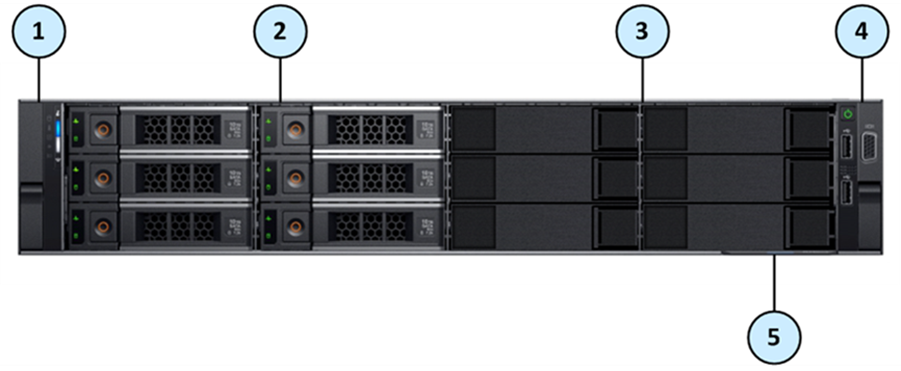

Front Panel
Item |
Component |
Description |
1 |
Left control panel |
Contains the status LED indicators and system notification LED indicator. |
2 |
Disk slots |
Enable you to install storage devices that are supported on your system. Smart-1 6000-L/6000-XL is supplied with 6 or 12 disks. You can install 6 additional disks if your system starts with 6 X 4TB disks. See Quantum Smart-1 6000-L/6000-XL Replacing Storage Devices. |
3 |
Disk blanks |
Disk blanks that cover the empty disk slots. |
4 |
Right control panel |
Contains the power button, two USB 2.0 ports, and a VGA connector. |
5 |
Service tag |
The service tag contains the MAC address, serial number, and the appliance model. The service tag is a slide-out label panel. |
