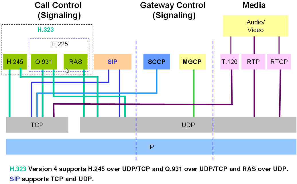

You can deploy VoIP over these protocols:
SIP (see Session Initiation Protocol (SIP))
MGCP (see MGCP-Based VoIP)
H.323 (see H.323-Based VoIP)
SCCP (see SCCP-Based VoIP)
