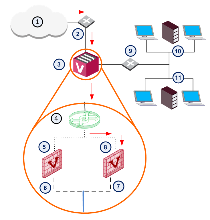

This diagram shows traffic from a physical VLAN switch that is sent to an interface on the VSX Gateway.
VSX automatically directs traffic arriving via VLAN Interface eth1.200 to Virtual System 2 according to the context defined by the VLAN ID.
Connection through a Virtual Switch
Traffic arriving via a Virtual Switch passes to the appropriate Virtual System based on the destination MAC address, as defined in the Virtual Switch forwarding table.
Traffic arrives at the Virtual System via the Warp Link associated with the designated MAC address.
If the destination MAC address does not exist in the Virtual Switch forwarding table, the traffic is broadcast over all defined Warp Links.
The Virtual Switch scenario is common for inbound traffic from external networks or the Internet.
Connection through a Virtual Router
Note - Security Groups in Maestro and Scalable Chassis do not support Virtual Routers (Known Limitation 01413513). |
Traffic arriving via a Virtual Router passes to the appropriate Virtual System based on entries in the Virtual Router routing table.
Routing may be destination-based, source-based or both. Traffic arrives to the designated Virtual System via its Warp Link.

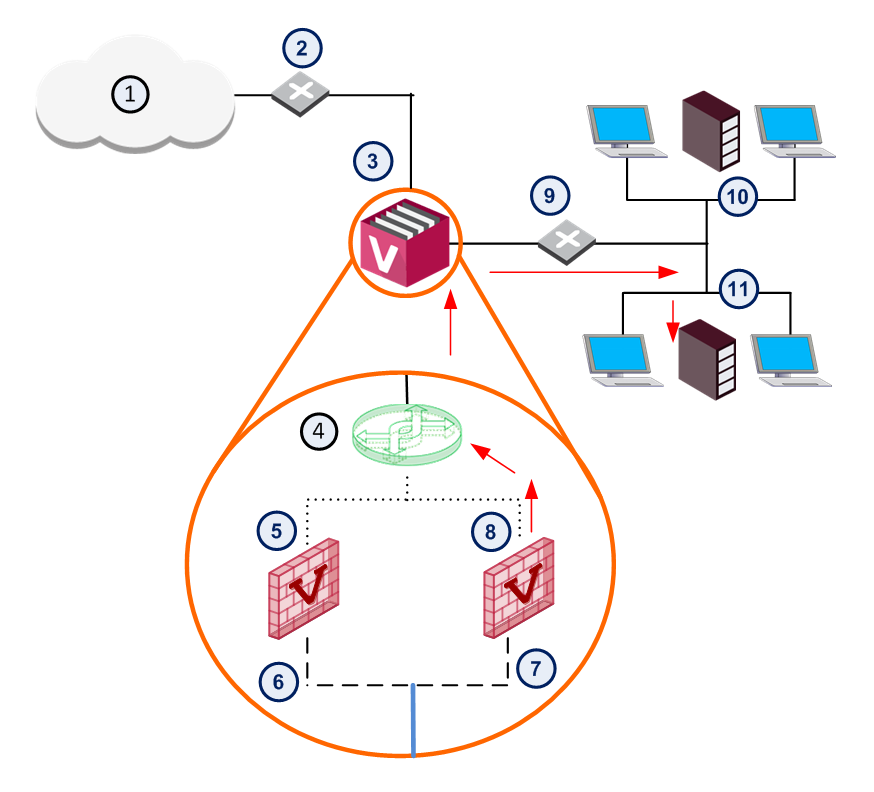

Security Enforcement
Since each Virtual System functions as an independent Security Gateway, it maintains its own, unique security policy to protect the network behind it. The designated Virtual System inspects all traffic and allows or blocks it based on the rules contained in the security policy.
Forwarding to Destination
Each Virtual System maintains its own unique configuration and rules for processing and forwarding traffic to its final destination. This configuration also includes definitions and rules for NAT, VPN, and other advanced features.
