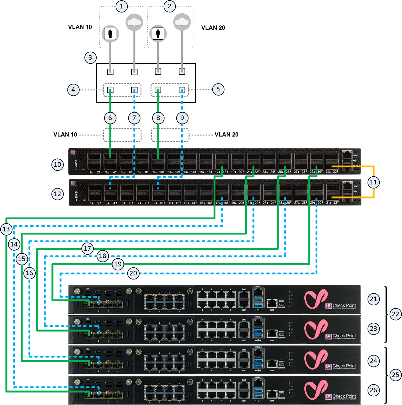

Item |
Description |
1 |
Network 1 in VLAN 10 connected to ports on the Networking Device (3). |
2 |
Network 2 in VLAN 20 connected to ports on the Networking Device (3). |
3 |
Networking Device (router or switch) that connects your Network 1 and Network 2 to the Quantum Maestro Orchestrators (10 and 12) with Bond interfaces (Link Aggregation). |
4 |
Bond interface that connects Network 1 to the Quantum Maestro Orchestrators (10 and 12). This Bond interface provides a redundant Uplink connection for the traffic inspected by the Security Appliances (26 and 24) in the applicable Security Group (25). |
5 |
Bond interface that connects Network 2 to the Quantum Maestro Orchestrators (10 and 12). This Bond interface provides a redundant Uplink connection for the traffic inspected by the Security Appliances (23 and 21) in the applicable Security Group (22). |
6 |
A DAC cable, Fiber cable (with transceivers), or Breakout cable that connects a first slave of the first Bond (4) on the Networking Device (3) to the first Quantum Maestro Orchestrator (10). This cable connects to the Uplink port 3 (interface |
7 |
A DAC cable, Fiber cable (with transceivers), or Breakout cable that connects a second slave of the first Bond (4) on the Networking Device (3) to the first Quantum Maestro Orchestrator (12). This cable connects to the Uplink port 3 (interface |
8 |
A DAC cable, Fiber cable (with transceivers), or Breakout cable that connects a first slave of the second Bond (5) on the Networking Device (3) to the second Quantum Maestro Orchestrator (10). This cable connects to the Uplink port 9 (interface |
9 |
A DAC cable, Fiber cable (with transceivers), or Breakout cable that connects a second slave of the second Bond (5) on the Networking Device (3) to the second Quantum Maestro Orchestrator (12). This cable connects to the Uplink port 9 (interface |
10 |
First Quantum Maestro Orchestrator. |
11 |
A DAC that connects the dedicated Synchronization ports 32 on the Quantum Maestro Orchestrators (10 and 12).
12 |
Second Quantum Maestro Orchestrator. |
13-20 |
DAC cables, Fiber cables (with transceivers), or Breakout cables that connect Downlink ports on Quantum Maestro Orchestrators to the Security Appliances. |
21-23 |
All Security Appliances assigned to the Security Group 2. |
24-26 |
All Security Appliances assigned to the Security Group 1. |
