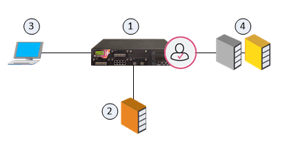

How AD Query Works - Firewall Rule Base
Item |
Description |
1 |
Identity Awareness Gateway |
2 |
Active Directory Domain Controller |
3 |
An end-computer, on which a user with Active Directory credentials logs on |
4 |
Network resources |
Flow of events:
The Identity Awareness Gateway (1) gets security event logs from the Active Directory Domain Controllers (2).
A user logs in on an end-computer with their Active Directory credentials (3).
The Active Directory Domain Controller (2) sends the security event log to the Identity Awareness Gateway (1).
The Identity Awareness Gateway (1) gets the user name (
@domain), computer name, and source IP address). -
The user on the end-computer (3) opens a connection to the network resource (4).
The Identity Awareness Gateway confirms the user identity and allows or blocks access to the resource based on the Security Policy
