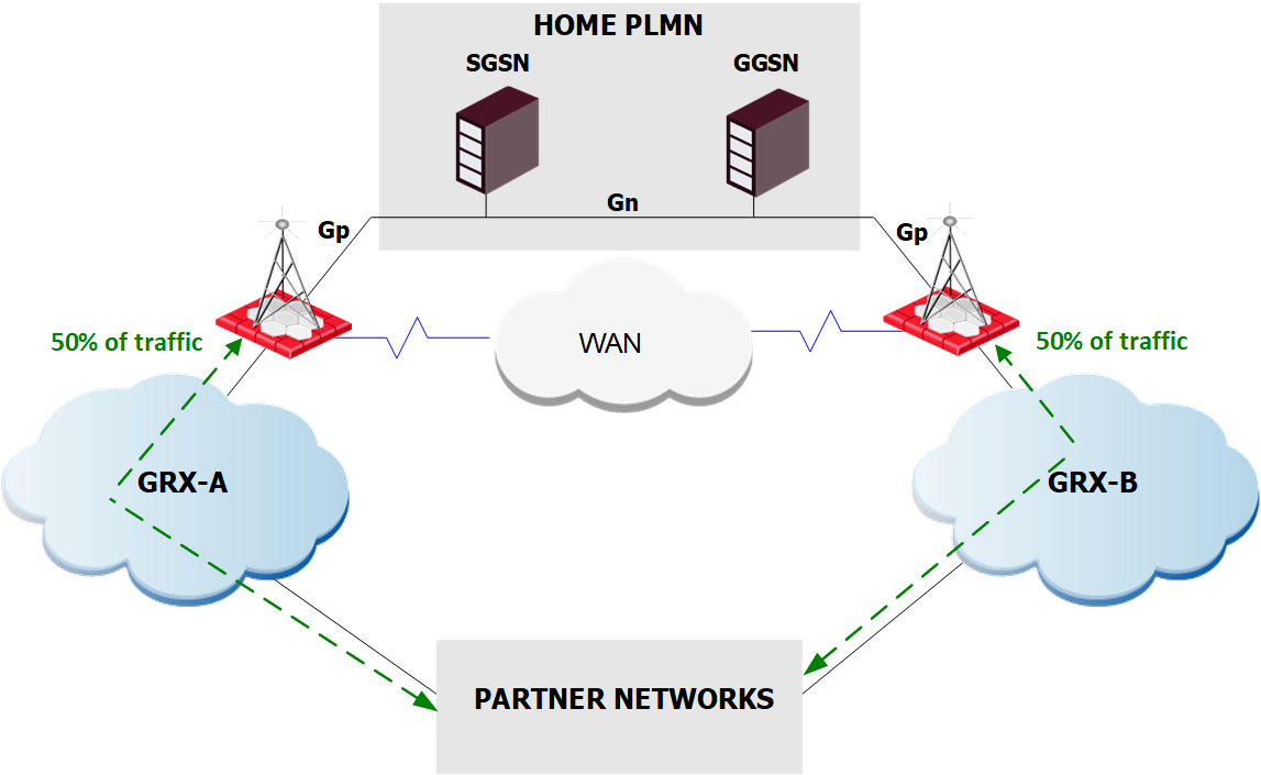

During normal operation, traffic is load-shared between the two GRXs, and consequently load-shared between the two Carrier Security Gateways. The traffic flow is according to the operator routing settings.
GRX load sharing during normal operation:

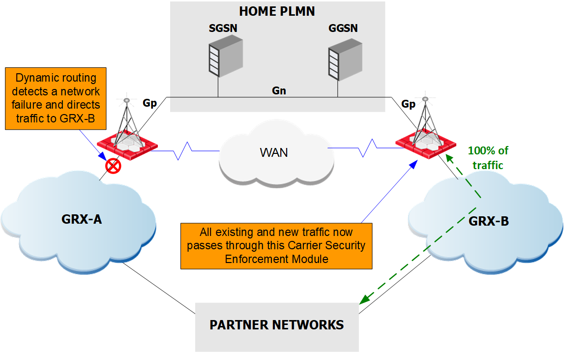

If any point on the network of one of the GRXs should fail, all traffic takes the path of the second, fully-functional GRX.
Traffic failover during GRX failure:
The path change occurs via dynamic routing settings using OSPF, BGP, etc. The data remains synchronized between the two Gateways.

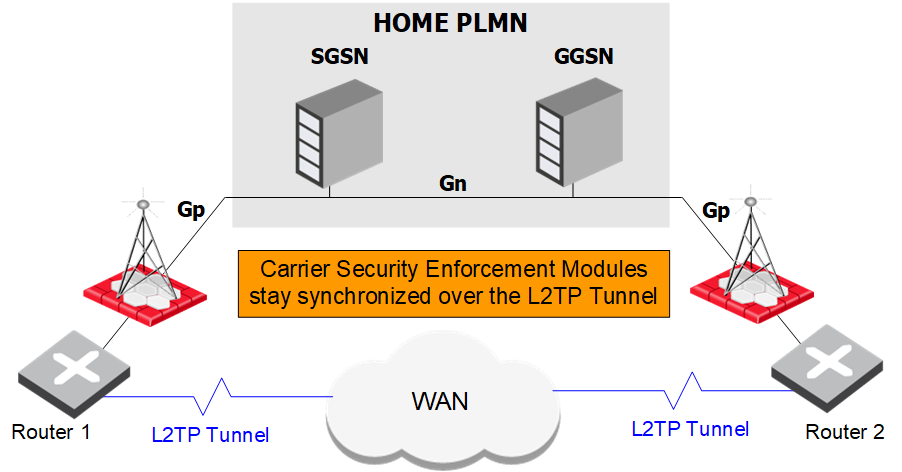

Set up a Layer 2 tunnel, such as L2TP, GRE, etc., between the two Carrier Security Gateways. The interfaces on both Gateways constituting the sync network should connect to the Layer 2 tunneling device on a LAN (or crossover cable).
Synchronizing Carrier Security over a WAN:
If desired, and the Layer 2 tunneling device supports it, establish encryption on the Layer 2 tunnel.
On the interfaces of the sync network, set the MTU to
1400. A value higher than 1400 may cause PMTU discovery procedures not supported by the tunneling device.
