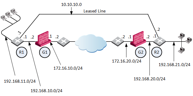

Automatic RIM
In this scenario:
Label |
Meaning |
R1 |
Router 1 |
G1 |
Security Gateway 1 |
R2 |
Router 2 |
G2 |
Security Gateway 2 |
RIM is enabled in the VPN community in which Security Gateway 1 and Security Gateway 2 participate.
When the Security Gateways create a VPN tunnel, and the Permanent Tunnel status changes to "UP", RIM updates the routing tables:
The routing table on Security Gateway 1 gets the routes for the encryption domain of Security Gateway 2.
The routing table on Security Gateway 2 gets the routes for the encryption domain of Security Gateway 1.
Security Gateway 1 has a dynamic routing neighborship with Router 1 and propagates RIM routes to Router 1.
Security Gateway 2 has a dynamic routing neighborship with Router 2 and propagates RIM routes to Router 2.
If the VPN tunnel becomes unavailable (Permanent Tunnel status with a peer changes to "DOWN"), then RIM removes routes from the routing tables of Security Gateway 1 and Security Gateway 2. The Security Gateways update their corresponding neighbors: Router 1 and Router 2. The routers start to send traffic over the leased line.
Below are the routing tables on the Security Gateways and Routers based on the diagram above. Entries in bold represent routes that RIM injected into the Security Gateway's local routing table:
For Security Gateway 1:
Destination |
Netmask |
Next Hop |
Metric |
0.0.0.0 |
0.0.0.0 |
172.16.10.2 |
1 |
192.168.21.0 |
255.255.255.0 |
172.16.10.2 |
1 |
192.168.11.0 |
255.255.255.0 |
192.168.10.1 |
1 |
Security Gateway 2:
Destination |
Netmask |
Next Hop |
Metric |
0.0.0.0 |
0.0.0.0 |
172.16.20.2 |
1 |
192.168.11.0 |
255.255.255.0 |
172.16.20.2 |
1 |
192.168.21.0 |
255.255.255.0 |
192.168.20.1 |
1 |
Router 1 (behind Security Gateway 1):
Destination |
Netmask |
Next Hop |
Metric |
0.0.0.0 |
0.0.0.0 |
192.168.10.2 |
1 |
192.168.21.0 |
255.255.255.0 |
192.168.10.2 |
1 |
192.168.21.0 |
255.255.255.0 |
10.10.10.2 |
2 |
Router 2 (behind Security Gateway 2):
Destination |
Netmask |
Next Hop |
Metric |
0.0.0.0 |
0.0.0.0 |
192.168.20.2 |
1 |
192.168.11.0 |
255.255.255.0 |
192.168.20.2 |
1 |
192.168.11.0 |
255.255.255.0 |
10.10.10.1 |
2 |

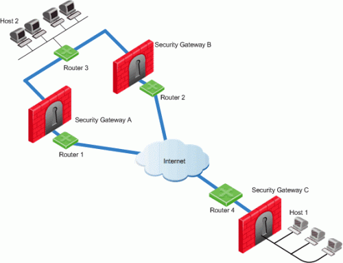

Injecting Peer Security Gateway Interfaces
You can inject the IP addresses of the peer Security Gateway into the routing tables, in addition to the networks behind the Security Gateway.
For example, after a VPN tunnel is created, RIM injects the encryption domain of the peer Security Gateway into the local routing tables of both Security Gateways. When RIM enabled Security Gateways communicate with a Security Gateway that has Hide NAT enabled, it is necessary to inject the peer's interfaces.
In this scenario:
Security Gateways A and B are both RIM enabled and Security Gateway C has Hide NAT enabled on the external interface ("hiding" all the IP addresses behind it).
Host 1, behind Security Gateway C, initiates a VPN tunnel with Host 2, through Security Gateway A.
Router 3 holds routes to all the hosts behind Security Gateway C. Because Router 3 does not have the Hide NAT IP address of Security Gateway C, Router 3 cannot properly route packets back to Host 1.
To route back packets:
Click > Global properties.
Click Advanced > Configure.
Open VPN Advanced Properties and select Tunnel Management.
Select RIM_inject_peer_interfaces. This injects Router 3 with all of the IP addresses of Security Gateway C (this includes the Hide NAT address).
Click OK.
Install the Access Control Policy.
Configure the router not to propagate the information injected to other Security Gateways. For example, in the scenario shown above this could result in Security Gateway B routing traffic to Security Gateway C through Security Gateway A.
