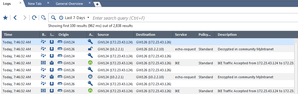

To make sure that a VPN tunnel works:
Locate the Access Control rule for the traffic that has to pass through the VPN tunnel.
In the Track column, select Log.
From the left navigation panel, click Logs & Events > Logs.
From the top, click New Tab.
From the bottom of the window, click Tunnel and User Monitoring.
Check Point SmartView Monitor opens.
Click the Security Gateway to see IPsec VPN
Check Point Software Blade on a Security Gateway that provides a Site to Site VPN and Remote Access VPN access. traffic and tunnels opened.A successful connection shows encrypt, decrypt and key install logs.
Alternatively:
In SmartConsole, from the left navigation panel, click Logs & Events.
On the Logs tab, search for VPN to see the applicable logs.
