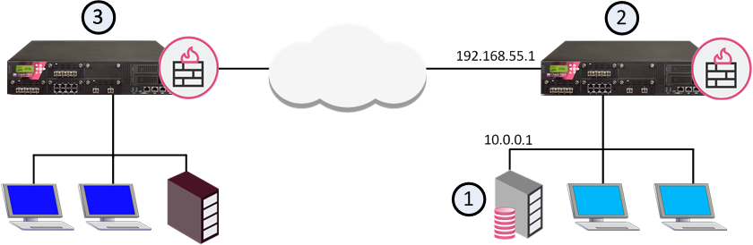

Example:
Item |
Description |
1 |
Primary Security Management Server.
2 |
Local Security Gateway that is directly connected to the Security Management Server. The Remote Security Gateway connects to the Security Management Server through this Local Security Gateway. |
3 |
Remote Security Gateway that must connect to the Security Management Server. |
Configuring NAT for Control Connections on the Security Management Server
From the left navigation panel, click Gateways & Servers.
Double-click the Security Management Server object.
From the left navigation tree, click NAT.
Select Add Automatic Address Translation rules.
In the Translation method field, select Static.
Configure the applicable IP address.
In our example - 192.168.55.1
Note - In a High Availability environment, you must configure one static IP address for each Security Management Server.
Select one of these two options:
Install on Gateway - The Security Gateway that performs this NAT. In our example, the local Security Gateway that is directly connected to the Security Management Server (item 2 in the diagram).
Do not create automatic NAT rules - The Security Management Server is behind a non-Check Point device that handles the NAT.
Connections from Security Gateways to this server. Select one of these options:
Based on topology configuration (use the server's translated or original IP address).
Use this server's original IP address.
Use this server's translated IP address.
Optional: Select Apply for Security Gateway control connections - This option performs NAT on VPN control connections to and from the Security Management Server. This makes it possible to install a policy or collect logs across a NAT gateway.
Click OK.
Install the Access Control Policy on the applicable Security Gateways.
