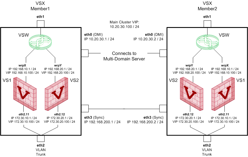

Example 2: VSX Cluster managed by Multi-Domain Server
This example shows:
One VSX
Virtual System Extension. Check Point virtual networking solution, hosted on a computer or cluster with virtual abstractions of Check Point Security Gateways and other network devices. These Virtual Devices provide the same functionality as their physical counterparts. Cluster
Two or more Security Gateways that work together in a redundant configuration - High Availability, or Load Sharing. in High Availability
Two VSX Cluster Members with DMI management connection

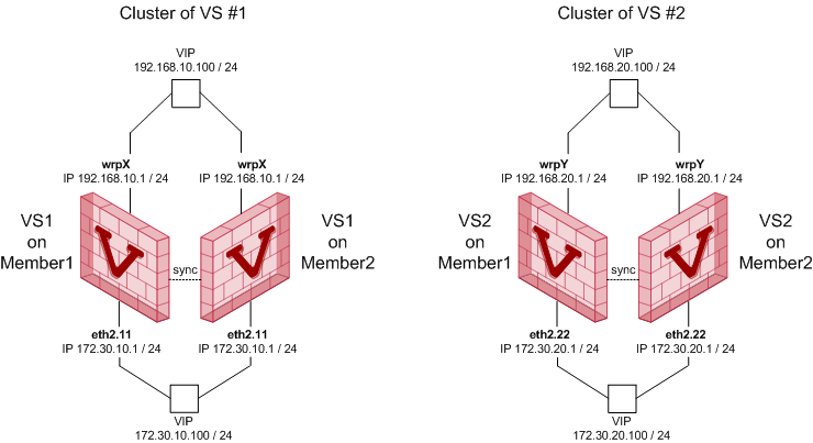

Two Virtual Systems:
External interface on each Virtual System
Virtual Device on a VSX Gateway or VSX Cluster Member that implements the functionality of a Security Gateway. Acronym: VS. connects directly to the Virtual Switch
Internal interface on each Virtual System connects to the VLAN Trunk interface
One Virtual System is configured with the IPsec VPN
Check Point Software Blade on a Security Gateway that provides a Site to Site VPN and Remote Access VPN access. Software Blade
Specific security solution (module): (1) On a Security Gateway, each Software Blade inspects specific characteristics of the traffic (2) On a Management Server, each Software Blade enables different management capabilities.
One Virtual System is configured with the Mobile Access
Check Point Software Blade on a Security Gateway that provides a Remote Access VPN access for managed and unmanaged clients. Acronym: MAB. Software Blade

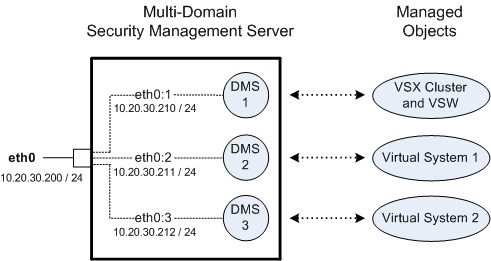

One Main Domain Management Server
Check Point Single-Domain Security Management Server or a Multi-Domain Security Management Server. manages the objects of the VSX Cluster and Virtual Switch
One Target Domain Management Server manages the object of the first Virtual System
One Target Domain Management Server manages the object of the second Virtual System

Create the Main Domain Management Server in SmartConsole to manage the VSX Cluster and Virtual Switch
Step
Instructions
A
Connect with SmartConsole to the Multi-Domain Server.
B
Create a new Domain and Domain Server.
In our example:
Name:
DMS1
IPv4:
10.20.30.210/24
C
From the left navigation panel, click Gateways & Servers.
D
Configure the Main Domain Management Server:
Connect with SmartConsole to the Main Domain Management Server (
DMS1
Configure the applicable Management Software Blades and settings.
Publish the SmartConsole session.
Create the Target Domain Management Server in SmartConsole to manage the Virtual System 1
Step
Instructions
A
B
In our example:
Name:
DMS2
IPv4:
10.20.30.211/24
C
D
Configure the Target Domain Management Server:
Connect with SmartConsole to the Target Domain Management Server (
DMS2
Create the Target Domain Management Server in SmartConsole to manage the Virtual System 2
Step
Instructions
A
B
In our example:
Name:
DMS3
IPv4:
10.20.30.212/24
C
D
DMS3
Install the VSX Cluster Member 1
See the R81 Installation and Upgrade Guide.
Step
Instructions
A
Install a Check Point appliance or Open Server.
B
Make sure you have enough physical interfaces for your VSX topology.
C Install Gaia OS.
D
Run the Gaia First Time Configuration Wizard.
These settings are specific to the VSX Cluster Member 1:
On the Management Connection page, select the interface for the DMI management connection and configure the applicable IPv4 address.
In our example:
eth0, 10.20.30.1/24
On the Internet Connection page, do not configure IP addresses on physical interfaces, to which your Virtual Systems connect directly.
On the Installation Type page, select Security Gateway and/or Security Management.
On the Products page, select Security Gateway.
On the Dynamically Assigned IP page, select No.
E
Make sure to enable the applicable physical interfaces:
To enable a physical interface in Gaia Portal
Web interface for the Check Point Gaia operating system.
Connect to the Gaia Portal in your web browser.
In our example:
https://10.20.30.1
Click Network Management > Network Interfaces.
In the upper left corner, click the lock icon to obtain the configuration lock.
Select the applicable physical interface > click Edit.
Select Enable.
Click OK.
To enable a physical interface in Gaia Clish
The name of the default command line shell in Check Point Gaia operating system. This is a restricted shell (role-based administration controls the number of commands available in the shell)., run:
set interface <Name of Physical Interface> state on
save config
F
Install the applicable licenses.

Create the VSX Cluster object with VSX Cluster Members in SmartConsole
See Configuring VSX Clusters and Working with VSX Clusters.
Step
Instructions
A
Connect with SmartConsole to the Main Domain Management Server that manages the objects of the VSX Cluster and Virtual Switch.
In our example:
DMS1
B
At the top, click Objects > More object types > Network Object > Gateways and Servers > VSX > New Cluster.
C
On the VSX Cluster General Properties (Specify the object's basic settings) page:
In the Enter the VSX Cluster Name field, enter the applicable name for this object.
In our example:
MyVsxCluster
In the Enter the VSX Cluster IPv4 field, enter the Cluster Virtual IPv4 address that is configured on the Dedicated Management Interfaces (DMI).
In our example:
10.20.30.100
In the Enter the VSX Cluster IPv6 field, enter the Cluster Virtual IPv6 address that is configured on the Dedicated Management Interfaces (DMI).
In the Select the VSX Cluster Version field, select the applicable Check Point version.
In our example:
R81
In the Select the VSX Cluster Platform field, select the applicable VSX Cluster mode:
ClusterXL - see Configuring a VSX Cluster in the High Availability Mode
ClusterXL Virtual System Load Sharing - see Configuring Virtual System Load Sharing
In our example:
ClusterXL
Click Next.
D
On the VSX Cluster Members (Define the members of this VSX Cluster) page:
Add the first VSX Cluster Member:
Click Add.
In the Cluster Member Name field, enter the applicable name for this object.
In our example:
MyVsxMember1
In the Cluster Member IPv4 Address field, enter the IPv4 address of the Dedicated Management Interface (DMI).
In our example:
eth0
,10.20.30.1
In the Enter the VSX Gateway IPv6 field, enter the applicable IPv6 address.
In the Activation Key field, enter the same Activation Key you entered during the First Time Configuration Wizard of this VSX Cluster Member.
In the Confirm Activation Key field, enter the same Activation Key again.
Click Initialize.
Click OK.
Enter the same Activation Key you entered in the
cpconfig
menu. -
Click Initialize.
If the Trust State field does not show Trust established, perform these steps:
Connect to the command line on the VSX Cluster Member.
Make sure there is a physical connectivity between the VSX Cluster Member and the Management Server (for example, pings can pass).
Run:
cpconfig
Enter the number of this option:
Secure Internal Communication
Follow the instructions on the screen to change the Activation Key.
On the VSX Cluster General Properties page, click Reset.
cpconfig
menu. -
Click Initialize.
E
Add the second VSX Cluster Member:
Click Add.
In our example:
MyVsxMember2
In our example:
eth0
,10.20.30.2
Click Initialize.
Click OK.
Click Next.
Run:
cpconfig
cpconfig
menu. -

On the VSX Cluster members (Synchronization Network) page:
Select the interface that will be used for state synchronization.
In our example:
eth3
Configure the IPv4 addresses for the Sync interfaces on each VSX Cluster Member.
In our example:
MyVsxMember1 - 192.168.200.1 / 255.255.255.0
MyVsxMember2 - 192.168.200.2 / 255.255.255.0
Click Next.
In our example:
DMS1

Create the first Virtual System object in SmartConsole
Step
Instructions
A
Connect with SmartConsole to the Target Domain Management Server that manages the object of the first Virtual System.
In our example:
DMS2
B
In SmartConsole, create the first Virtual System object:
SeeWorking with Virtual Systems.
At the top, click Objects > More object types > Network Object > Gateways and Servers > VSX > New Virtual System.
C
On the VSX System General Properties (Define the object name and the hosting VSX) page:
In the Name field, enter the applicable name for this object.
In our example:
MyVs1
In the VSX Gateway / Cluster field, select the applicable VSX Gateway or VSX Cluster object.
In our example:
MyVsxCluster
Click Next.
D
On the Virtual System Network Configuration (Define Virtual System Interfaces and Routes) page:
In our example, this Virtual System connects to the Virtual Switch ("external") and to the physical VLAN Trunk interface ("internal") on the VSX Cluster Members.
In the Interfaces section, add the "external" interface:
Click Add > Leads to Virtual Switch.
Add Interface window opens.
In the Leads to field, select the Virtual Switch your created earlier.
In our example:
MyVsxVsw
In the IPv4 Configuration section, enter the applicable IP Address and Net Mask.
In our example:
192.168.10.1/24
In the IPv6 Configuration section, enter the applicable IPv6 Address and Prefix.
Click OK.
In the Interfaces section, add the "internal" interface:
Click Add > Regular.
In the Interface field, select the applicable physical interface - this is the "internal" interface.
In our example:
eth2
(that is marked as VLAN Trunk) -
In the VLAN tag field, enter the applicable number between 2 and 4094.
In our example:
11
(to configureeth2.11
In our example:
172.30.10.1/24
You can select Propagate route to adjacent Virtual Devices (IPv4) to "advertise" this Virtual System to neighboring Virtual Devices. This enables IPv4 connectivity between the neighboring Virtual Devices.
You can select Propagate route to adjacent Virtual Devices (IPv6) to "advertise" this Virtual System to neighboring Virtual Devices. This enables IPv6 connectivity between the neighboring Virtual Devices.
Click OK.
In the Routes section, click Add to configure the applicable static routes and the Default Route.
Click Next.
E
On the Virtual System Cluster Creation Finalization page:
Click Finish and wait for the operation to finish.
Click View Report for more information.
Click Close.
In our example:
DMS3
In our example:
MyVsxVsw
In our example:
192.168.20.1/24
Click OK.
In our example:
eth2
In our example:
22
(to configureeth2.22
In our example:
172.30.20.1/24
Click OK.
Click Next.
