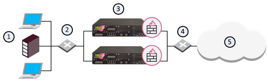

ClusterXL is a Check Point software-based cluster
Two or more Security Gateways that work together in a redundant configuration - High Availability, or Load Sharing. solution for Security Gateway
Dedicated Check Point server that runs Check Point software to inspect traffic and enforce Security Policies for connected network resources. redundancy and Load Sharing. A ClusterXL Security Cluster contains identical Check Point Security Gateways.
A High Availability Security Cluster ensures Security Gateway and VPN connection redundancy by providing transparent failover to a backup Security Gateway in the event of failure.
A Load Sharing Security Cluster provides reliability and also increases performance, as all members are active.
Item |
Description |
1 |
Internal network |
2 |
Switch for internal network |
3 |
Security Gateways with ClusterXL Software Blade |
4 |
Switch for external networks |
5 |
Internet |
