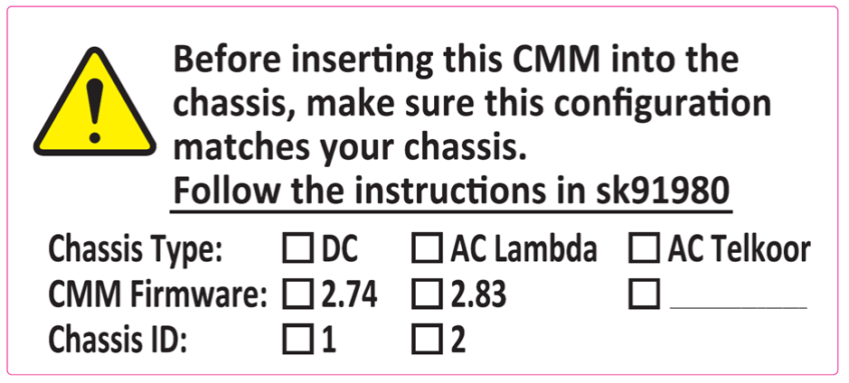

  2. Get the label from the CMM box.
    Example:
  3. Make sure that the Standby Chassis ID on the label on the outside of the CMM packaging box is the same as the label on the Standby Chassis.
    If the Chassis ID is different from the Chassis ID of the RMA CMM, change the RMA CMM Chassis ID. See Setting the Chassis ID.

The output must be the same as the box label.
