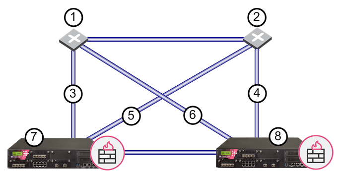

Fully Meshed Redundancy through Interface Bonding
The Link Aggregation High Availability mode, when deployed with ClusterXL, enables a higher level of reliability by providing granular redundancy in the network.
This granular redundancy is achieved by using a fully meshed topology, which provides for independent backups for both NICs and switches.
Item
Description
Item
Description
1
Switch 1
5
Network connection 2
2
Switch 2
6
Network connection 3
3
Network connection 1
7
VSX Cluster Member 1
4
Network connection 4
8
VSX Cluster Member 2
In this scenario - VSX Cluster Members 1 and 2 are configured in the High Availability mode.
