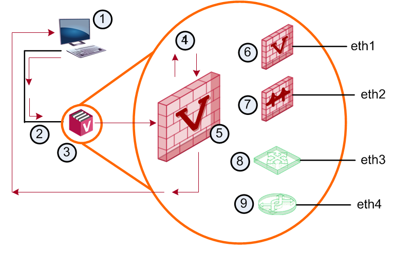

SNMP Default Mode
In SNMP default mode:
The SNMP daemon runs only in the context of VS0 (the VSX Gateway).
The VS0 SNMP daemon has a set of tables with counters (VSX SNMP tree) for each Virtual Device.
SNMP queries must be sent to IP address of the VSX Gateway (context is VS0).

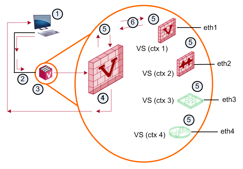

SNMP VS Mode
In SNMP VS mode:
Each Virtual Device has separate SNMP daemon running in the context of that Virtual Device.
Query for Virtual Devices uses the VS0 IP address.
You must run the SNMP query using the interface on the VSX Gateway.
The query is relayed to the specified Virtual Device.
The Virtual Device sends the response through the same VSX Gateway interface.
The VS ID must be specified in the SNMP query.
Note - Default mode query functionality is not decreased when you enable SNMP VS mode. |

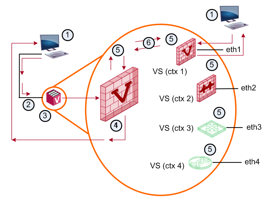

SNMP VS in the "vs-direct-access" Mode
SNMP VS in the
vs-direct-access
mode is available only when the SNMP VS mode is enabled. -
Enables SNMP queries on the IP address of a Virtual System (not only VS0), or Virtual Router.
Notes:
For cluster deployments, you can query only Virtual IP addresses.
Only Virtual Devices with an IP address can be queried, not Virtual Switches or Virtual Bridges.

If you enable the vs-direct-access mode, the Virtual System accepts SNMP queries on all the interfaces.
To prevent SNMP queries for a specified interface, add a new rule to the policy that blocks SNMP traffic on that interface.
Query source
In the vs mode and the vs-direct-access mode, there is no specification for query source.
All sources allowed in the Security Policy are valid.
