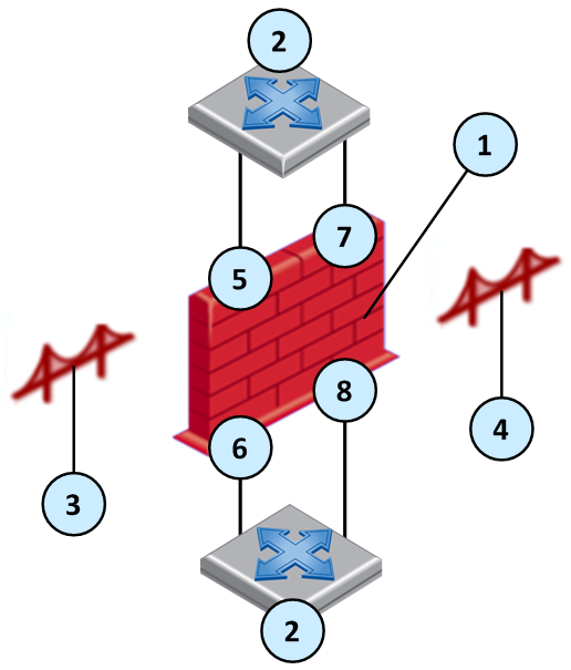

Access Mode VLAN and Trunk Mode VLAN
VLAN traffic can pass through a Bridge interface in one of these modes:
If you configure the switch ports in Access Mode, create the Bridge interface with two VLAN interfaces as its subordinate interfaces.
For VLAN translation, use different numbered VLAN interfaces to create the Bridge interface.
You can build multiple VLAN translation bridges on the same Security Gateway Dedicated Check Point server that runs Check Point software to inspect traffic and enforce Security Policies for connected network resources..
Configure two VLAN interfaces.
Create a Bridge interface and select the VLAN interfaces as its subordinate interfaces (see Bridge Interfaces).
Note - VLAN translation is not supported over bridged ports of a FONIC (Fail-Open NIC, see sk85560). |
Item |
Description |
1 |
Security Gateway |
2 |
Switch |
3 |
Access mode bridge 1 with VLAN translation |
4 |
Access mode bridge 2 with VLAN translation |
5 |
VLAN 3 (eth 1.3) |
6 |
VLAN 33 (eth 2.33) |
7 |
VLAN 2 (eth 1.2) |
8 |
VLAN 22 (eth 2.22) |
