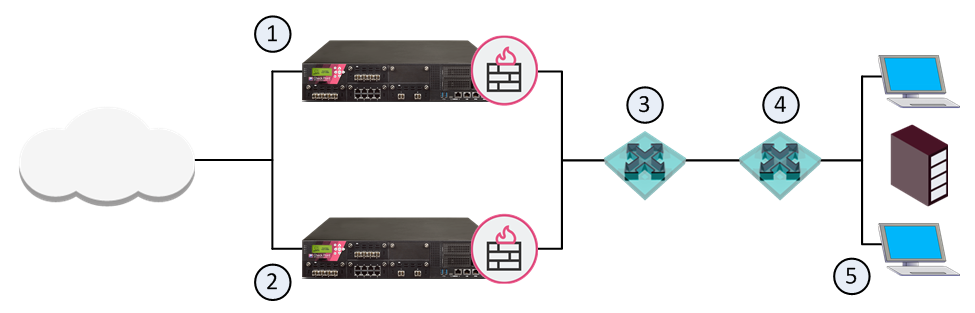

This is a simple VRRP use case, where Security Gateway 1 is the VRRP Master, and Security Gateway 2 is the VRRP Backup.
Virtual Router redundancy is available only for connections to and from the internal network.
There is no redundancy for external network traffic.
Item |
Description |
1 |
VRRP Master Security Gateway |
2 |
VRRP Backup Security Gateway |
3 |
Virtual Router VRID 5 - Virtual IP Address (Backup Address) is 192.168.2.5 |
4 |

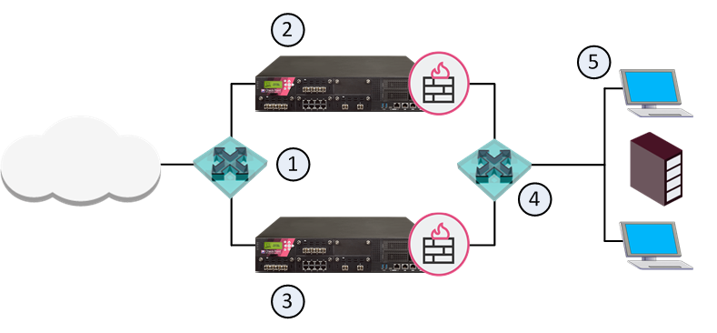

This use case shows an example of an environment, where there is redundancy for internal and external connections.
Here, you can use Virtual Routers for the two Security Gateways - for internal and for external connections.
The internal and external interfaces must be on different subnets.
Configure one Security Gateway as the VRRP Master and one Security Gateway as the VRRP Backup.
Item |
Description |
1 |
Virtual Router VRID 5 - External Virtual IP Address (Backup Address) is 192.168.2.5 |
2 |
3 |
4 |
Virtual Router VRID 5 - Internal Virtual IP Address (Backup Address) is 192.168.3.5 |
5 |
Internal network and hosts |

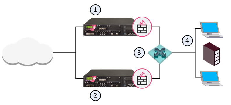

This use case shows an example of an Active/Active Load Sharing environment for internal network traffic.
This environment gives load balancing, as well as full redundancy.
This configuration is supported with ClusterXL disabled. Only Static Routes are supported.
The monitoring of the Check Point Firewall by VRRP must be disabled (it is enabled by default).
A maximum of two VRIDs is supported per interface.
Security Gateway 1 is the VRRP Master for VRID 5, and Security Gateway 2 is the VRRP Backup.
Security Gateway 2 is the VRRP Master for VRID 7, and Security Gateway 1 is the VRRP Backup.
The two Security Gateways are configured to back each other up. If one fails, the other takes over its VRID and IP addresses.
Item |
Description |
1 |
VRRP Master Security Gateway for VRID 5 and VRRP Backup for VRID 7 |
2 |
VRRP Backup Security Gateway for VRID 5 and VRRP Master for VRID7 |
3 |
Virtual Router, VRID 5 Virtual IP Address (Backup Address) is 192.168.2.5 |
4 |
Virtual Router, VRID 7 Virtual IP Address (Backup Address) is 192.168.2.7 |
5 |
