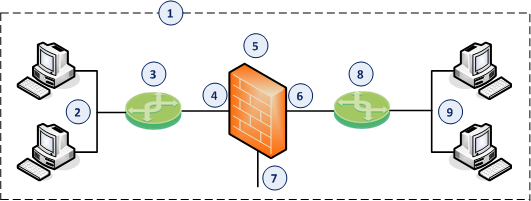

Example Topology for Bridge Mode
Item
Description
1
Network, which an administrator needs to divide into two Layer 2 segments.
The Security Group in Bridge Mode connects between these segments.
2
First network segment.
3
Switch that connects the first network segment to one bridged slave interface (4) on the Security Group in Bridge Mode.
4
One bridged slave interface (for example, eth1-05) on the Security Group in Bridge Mode.
5
6
Another bridged slave interface (for example, eth1-07) on the Security Group in Bridge Mode.
7
Dedicated Gaia Management Interface (for example, eth1-Mgmt1) on the Security Group.
8
Switch that connects the second network segment to the other bridged slave interface (6) on the Security Group in Bridge Mode.
9
Second network segment.
