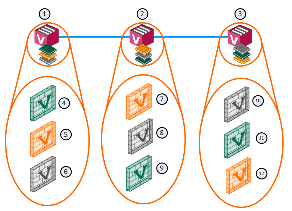

In an example deployment scenario with three VSX Cluster Members, each with three Virtual Systems: an equalized Load Sharing deployment might have one Active Virtual System on each VSX Cluster Member.
Item
Description
Item
Description
1
VSX Cluster Member 1
8
Virtual System 2 is Backup
2
VSX Cluster Member 2
9
Virtual System 3 is Active
3
VSX Cluster Member 3
10
Virtual System 1 is Backup
4
Virtual System 1 is Active
11
Virtual System 2 is Active
5
Virtual System 2 is Standby
12
Virtual System 3 is Standby
6
Virtual System 3 is Backup
Sync Network
7
Virtual System 1 is Standby
A different member hosts the active peer for each Virtual System. This distribution spreads the load equally between the VSX Cluster Members.
When you create a Virtual System, VSX automatically assigns Standby and Backup states to the applicable peers and distributes them between the other VSX Cluster Members.

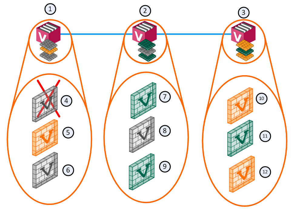

In the event that an individual active Virtual System fails, it immediately fails over to its Standby peer and one of its Backup peers becomes the Standby, synchronizing with the newly Active peer.

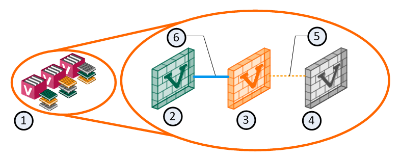

VSLS adds a Backup state to the existing Active and Standby states.
The Backup state contains the latest configuration settings for each Virtual System, but does not receive state table synchronization.
The figure below illustrates the relationship between Virtual System states.
Item
Description
1
VSX Cluster with 3 Cluster Members, each running 3 Virtual Systems (2, 3, and 4)
2
Virtual System 1 on VSX Cluster Member 1 is Active
3
Virtual System 1 on VSX Cluster Member 2 is Standby
4
Virtual System 1 on VSX Cluster Member 3 is Backup
5
Policy updates only
6
State tables are synchronized
Each Virtual System peer in a VSLS cluster is replicated on all VSX Cluster Members, and each copy exists in a different state.
The Active and Standby states are synchronized, so that the Standby peer can immediately become Active in the event of a failure of the Active Virtual System or VSX Cluster Member.
When this happens, the Backup peer becomes the Standby, and immediately synchronizes with the new Active Virtual System.
VSLS reduces the load on the synchronization network by not synchronizing the Backup Virtual System state tables with the Active Virtual System until a failover occurs.

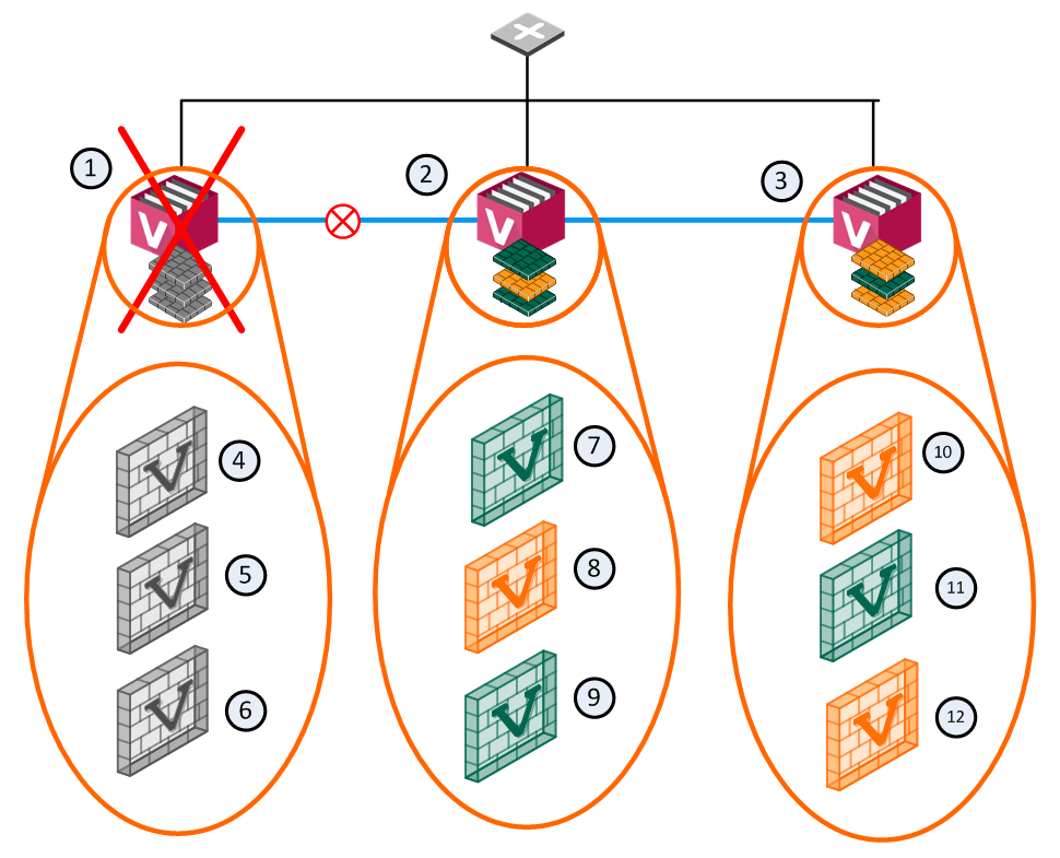

In the event that a member fails or experiences a connectivity problem, VSLS detects the problem and routes traffic for the affected Virtual Systems to their corresponding Standby Virtual Systems.
Standby Virtual Systems, which are fully synchronized with their active peers, change immediately to the Active state and preserve active connections.
At the same time, the backup Virtual Systems switch to Standby, and synchronize fully with the newly active Virtual Systems.
Item
Description
Item
Description
1
8
2
9
3
10
4
Virtual System 1 is Down
11
5
Virtual System 2 is Down
12
6
Virtual System 3 is Down
Sync Network
7
Network Traffic
In this scenario, VSX Cluster Member 1 fails and its Active and Standby Virtual Systems fail over to VSX Cluster Member 2 and VSX Cluster Member 3.
The Active Virtual System (VS1) moves to VSX Cluster Member 2 and directs all VS1 traffic itself.
Its Backup peer on VSX Cluster Member 3 synchronizes with the new Active Virtual System and becomes the Standby.
VS2 on VSX Cluster Member 2 becomes the Standby and synchronizes with the Active peer on VSX Cluster Member 3.
For VS3, the Active and Standby peers remain the same.

In a failure scenario where an active Virtual System fails on one member, but the Standby and Backup Virtual Systems remain up: the Active Virtual System fails over to its Standby peer, and its Backup becomes the Standby.
The new Standby synchronizes with the new Active member.
Item
Description
Item
Description
1
Member 1
8
VS 2 Backup
2
Member 2
9
VS 3 Active
3
Member 3
10
VS 1 Standby
4
VS 1 Down
11
VS 2 Active
5
VS 2 Standby
12
VS 3 Standby
6
VS 3 Backup
Sync Network
7
VS 1 Active
All other Virtual Systems continue to function as usual, and no failover occurs.
