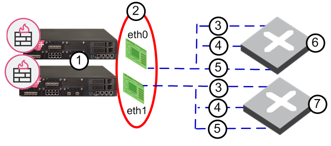

Bond Failover
Either of the following failure scenarios can induce bond failover:
An active interface detects a link state failure in another monitored interface
ClusterXL detects a failure in sending or receiving Cluster
Two or more Security Gateways that work together in a redundant configuration - High Availability, or Load Sharing. Control Protocol (CCP) keep-alive packets
Either of these occurrences will induce a failover, either to another subordinate interface within the bond, or between VSX Virtual System Extension. Check Point virtual networking solution, hosted on a computer or cluster with virtual abstractions of Check Point Security Gateways and other network devices. These Virtual Devices provide the same functionality as their physical counterparts. Cluster Members, depending on the circumstances.
Note - The bond failover operation requires a network interface card that supports the Media-Independent Interface (MII) standard. |
Link State Initiated Failover
Link-state initiated failover occurs in this sequence:
The active subordinate interface detects a down link state.
The bond initiates failover to a standby interface. Since this is a failover within the bond, the status of the other VSX Cluster Member
Security Gateway that is part of a cluster. is unaffected.
When the number of available subordinate interfaces is fewer than the critical minimum number of interfaces, failover to other VSX Cluster Members occurs (see Setting Critical Required Interfaces).
If the standby interface continues to detect a link failure, and the initial interface is still down, failover to other VSX Cluster Members occurs.
