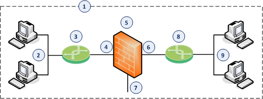

Example Topology for Bridge Mode
Item |
Description |
1 |
Network, which an administrator needs to divide into two Layer 2 segments. The Security Group in Bridge Mode connects between these segments. |
2 |
First network segment. |
3 |
Switch that connects the first network segment to one bridged slave interface (4) on the Security Group in Bridge Mode. |
4 |
One bridged slave interface (for example, |
5 |
6 |
Another bridged slave interface (for example, |
7 |
Dedicated Gaia |
8 |
Switch that connects the second network segment to the other bridged slave interface (6) on the Security Group in Bridge Mode. |
9 |
Second network segment. |
