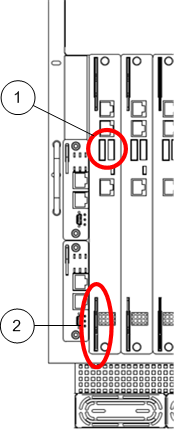

Example:
Item
Description
1
USB port
2
One of two latches for extracting and inserting the SGM
