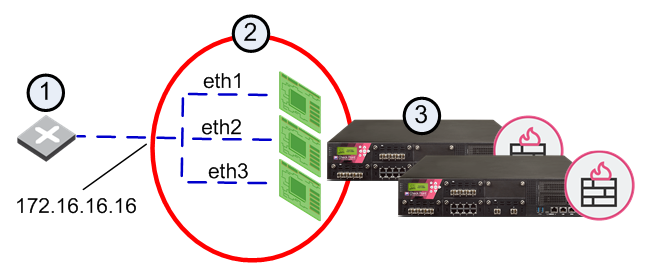

A bond contains a minimum of one and may contain up to eight subordinate interfaces. All subordinate interfaces contained in a bond share a common IP address and may share the same MAC address. We recommend that each cluster member
Security Gateway that is part of a cluster. contain the same quantity of identical subordinate interfaces.
Item |
Description |
1 |
Switch |
2 |
bond 0 |
3 |
Cluster |

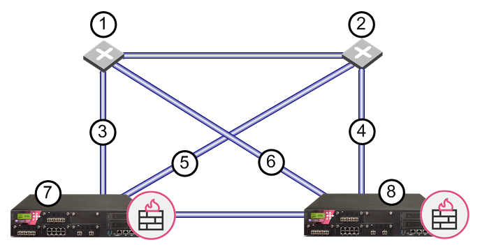

Fully Meshed Redundancy through Interface Bonding
The Link Aggregation High Availability mode, when deployed with ClusterXL, enables a higher level of reliability by providing granular redundancy in the network.
This granular redundancy is achieved by using a fully meshed topology, which provides for independent backups for both NICs and switches.
In this scenario - VSX Cluster Members 1 and 2 are configured in the High Availability mode.
