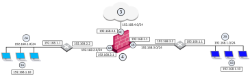

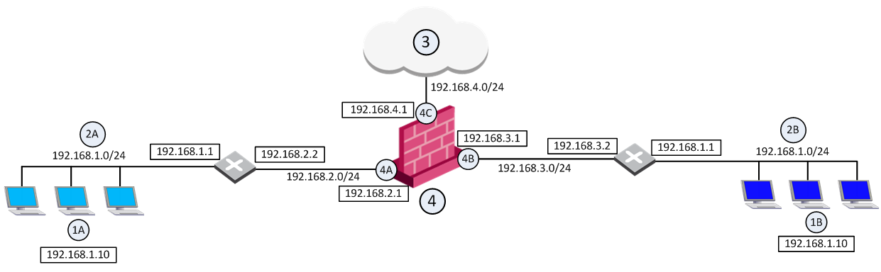

Example Network Configuration
Example topology:
For example, assume both Network 2A and Network 2B share the same address space (192.168.1.0/24).
Therefore, it is not possible to use standard NAT to enable communication between the two networks.
Instead, it is necessary to perform overlapping NAT on a per-interface basis.
Users in Network 2A, who want to communicate with users in Network 2B, must use the 192.168.30.0/24 network as a destination.
Users in Network 2B, who want to communicate with users in Network 2A, must use the 192.168.20.0/24 network as a destination.
The Security Gateway (4) translates the IP addresses in this way for each individual interface:

Communication Examples
If user 1A, at IP address 192.168.1.10 in Network 2A, wants to connect to user 1B, at IP address 192.168.1.10 (the same IP address) in Network 2B, user 1A opens a connection to the IP address 192.168.30.10.
User 1A, at IP address 192.168.1.10 in Network 2A, connects to IP address 192.0.2.10 on the Internet (3).
