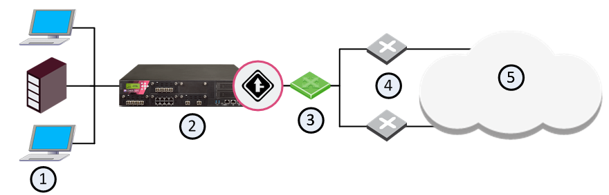

  2. Each managed line must be connected (directly or indirectly via a router) to a separate physical interface on the QoS machine. Two managed lines cannot share a physical interface to the QoS gateway, and two network segments cannot connect to the same router.
For example, in the configuration depicted in the following diagram, the routers can pass traffic to each other through the hub without the QoS gateway being aware of the traffic.
Item
Description
1
Internal network
2
Security Gateway with QoS enabled
3
Hub
4
Routers
5
Internet

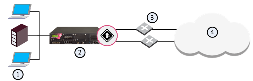

You cannot manage two networks connected to a single router since traffic may pass from one line to the other directly through the router, without the QoS gateway being aware of the traffic:
Item
Description
1
Internal network
2
3
Routers
4
Internet
In a correct configuration, the routers connect directly to the QoS gateway.

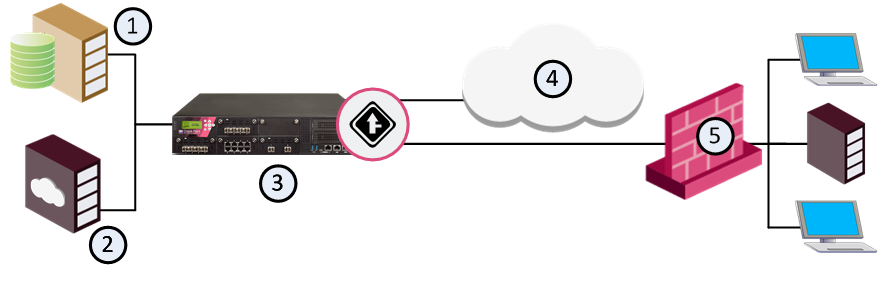

Frame Relay Network
Item
Description
1
Database server
2
Web server
3
4
Internet
5
Branch office
The previous diagram shows that the branch office communicates with the central site and the opposite. It only communicates directly with the Internet through the central site. The Web server makes important company documents available to the branch office, and the database server supports the company's mission-critical applications.
The problem is that most of the branch office traffic is internal and external Web traffic, and the mission-critical database traffic suffers as a result. The network administrator has considered upgrading the 56K lines, but is reluctant to do so, not only because of the cost but also because upgrading would probably not solve the problem. The upgraded lines would still be filled mostly with Web traffic.
The goals are as follows:
  1. Allocate the existing bandwidth so that access to the database server gets the largest share.
  2. Take into account that the branch offices are connected to the network by 56K lines.
These goals are accomplished with the following Rule BaseClosed All rules configured in a given Security Policy. Synonym: Rulebase.:
Main Rules
Rule Name
Source
Destination
Service
Action
Office 1
Office 1
Any
Any
Weight 10
Limit 56KBps
Office n
Office n
Any
Any
Weight 10
Limit 56KBps
Default
Any
Any
Any
Weight 10
Each office has sub-rules:
Office Sub-Rules
Rule Name
Source
Destination
Service
Action
Start of Sub-RuleClosed Set of traffic parameters and other conditions in a Rule Base (Security Policy) that cause specified actions to be taken for a communication session.
Database Rule
Any
Database server
Database service
Weight 50
Web Rule
Any
Web Server
http
Weight 10
Branch Offices
Any
Any
Any
Weight 10
End of Sub Rule
The sub-rules give database traffic priority over Web traffic and other traffic.
