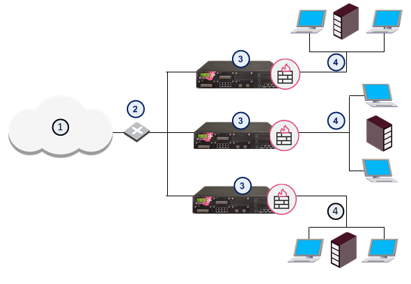

Example Physical Network Topology
In a typical deployment with multiple Security Gateways, each protects a separate network.
Each physical Security Gateway has interfaces to the perimeter router and to the network it protects.
Item
Description
1
Internet
2
Router
3
Security Gateways
4
Network

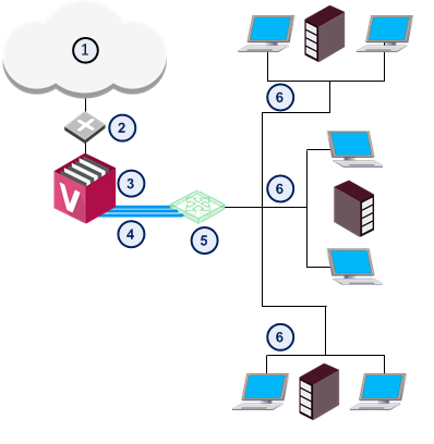

Example VSX Virtual Network Topology
Deploy one VSX Gateway with four Virtual Systems to protect multiple networks.
Item
Description
1
Internet
2
Router
3
VSX Gateway.
Each Virtual System in a VSX environment is a Security Gateway, with the same security and networking functionality as a physical gateway.
Each handles packet traffic to and from the one network it protects.
4
Warp Links.
Virtual interfaces and network cables connect the Virtual Systems and the Virtual Switch.
5
Virtual Switch.
Connects all the Virtual Systems to the Internet router.
6
Networks
