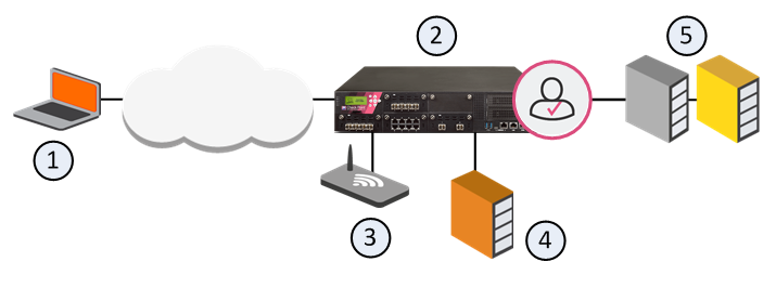

Browser-Based Authentication with Captive Portal
Item
Description
1
User
2
Identity Awareness Gateway
3
Captive Portal
4
Active Directory Domain Controller
5
Internal Data Center
Flow of events for Browser-Based Authentication with Captive Portal
A user (1) wants to access the Internal Data Center (5).
Identity Awareness Gateway (2) does not recognize the user and redirects the user's web browser to the Captive Portal (3).
The user enters regular office credentials. The credentials can be AD or other Check Point supported authentication methods, such as LDAP, Check Point internal credentials, or RADIUS.
The credentials go to the Identity Awareness Gateway, which finds them in the AD server (4).
The user can access the requested URL in the Data Center (5).
