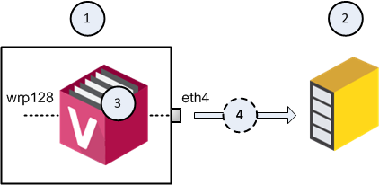

Example topology for one Virtual System:
Item |
Description |
1 |
VSX Gateway. |
2 |
Recorder, or Packet-Broker that works in a monitor (promiscuous) mode. |
3 |
Virtual System, through which your networks send and receive their traffic. |
4 |
Flow of the decrypted and mirrored traffic from the VSX Gateway (1) to the Recorder, or Packet-Broker (2). |
eth4 |
Designated physical interface on the VSX Gateway (1). Virtual System (3) connects directly to this physical interface. |
wrp128 |
One of the virtual interfaces on the Virtual System (3). |

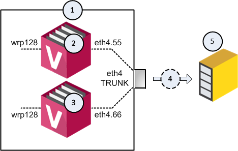

Example topology for several Virtual Systems:
Note - This topology requires you to configure a VLAN Trunk on the Recorder or Packet-Broker. The VLAN Trunk on the Recorder or Packet-Broker must accept all VLAN IDs that you configure in the objects of the applicable Virtual Systems in SmartConsole.
Item |
Description |
1 |
VSX Gateway. |
2 |
First Virtual System, through which your networks send and receive their traffic. |
3 |
Second Virtual System, through which your networks send and receive their traffic. |
4 |
Flow of the decrypted and mirrored traffic from the VSX Gateway (1) to the Recorder, or Packet-Broker (5). |
5 |
Recorder, or Packet-Broker. |
eth4 |
Designated physical interface on the VSX Gateway (1). This interface is configured as VLAN Trunk in the VSX Gateway object in SmartConsole. Virtual Systems (2 and 3) connect to this VLAN Trunk interface with VLAN interfaces. |
eth4.55 |
VLAN interface on the first Virtual System (2). |
eth4.66 |
VLAN interface on the second Virtual System (3). |
wrp128 |
One of the virtual interfaces on the Virtual Systems (2 and 3). |
