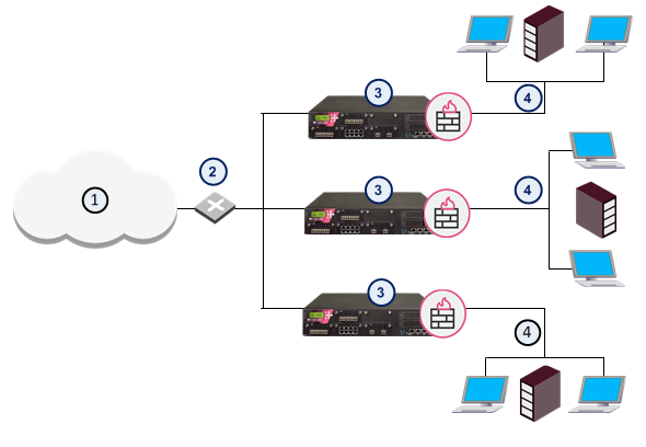

Physical Network Topology
In a typical deployment with multiple Security Gateways, each protects a separate network. Each physical Security Gateway has interfaces to the perimeter router and to the network it protects.
Item |
Description |
1 |
Internet |
2 |
Router |
3 |
Security Gateways |
4 |
Network |

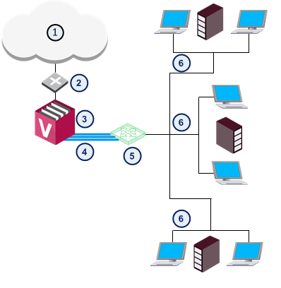

VSX Virtual Network Topology
Deploy one VSX Gateway with four Virtual Systems to protect multiple networks.
Item |
Description |
1 |
Internet |
2 |
Router |
3 |
VSX Gateway. Each Virtual System in a VSX environment is a Security Gateway, with the same security and networking functionality as a physical gateway. Each handles packet traffic to and from the one network it protects. |
4 |
Warp Links. Virtual interfaces and network cables connect the Virtual Systems and the Virtual Switch |
5 |
Virtual Switch. Connects all the Virtual Systems to the Internet router. |
6 |
Networks |
