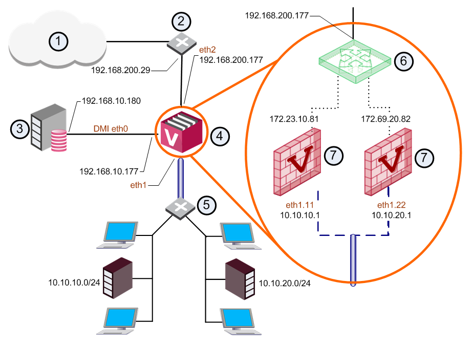

Virtual Device on a VSX Gateway or VSX Cluster Member that functions as a physical router. Acronym: VR.. As with physical routers, each Virtual Router maintains a routing table containing entries that describe known networks and directions on how to reach them.
You can define Virtual Routers for both external and internal communications. A Virtual Router that connects to external networks, including a DMZ and the Internet, are referred to as an external Virtual Router. A Virtual Router that connects to internal, protected networks is known as an internal Virtual Router.
Item |
Description |
Item |
Description |
1 |
Internet |
6 |
External Virtual Router |
2 |
Router |
7 |
Virtual Systems |
3 |
VLAN Interface |
4 |
VLAN Trunk |
5 |
VLAN switch |
An external Virtual Router functions as the external gateway for Virtual Systems, allowing them to share one secure physical interface leading to external networks and the Internet.

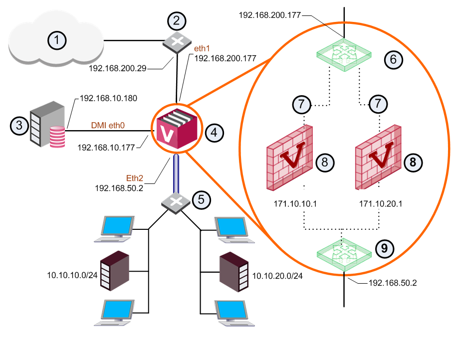

In this scenario, VSX creates Warp interfaces between the Virtual Systems and both Virtual Routers. Note that the external Virtual System
Virtual Device on a VSX Gateway or VSX Cluster Member that implements the functionality of a Security Gateway. Acronym: VS. interfaces are defined as unnumbered interfaces.
An internal Virtual Router typically connects with one interface leading to internal networks through a switch with additional Warp Links leading to other Virtual Systems located in the VSX Gateway.
After you create a new Virtual Router, add new interfaces to the Virtual Systems to connect to the Virtual Router.
