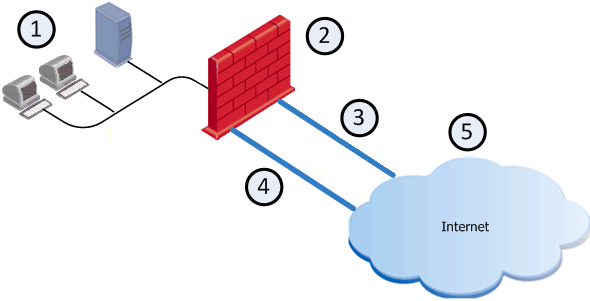

Example of a typical deployment with two dedicated physical interfaces for two ISP links
Best Practice - We recommend this deployment, because it is simpler than deployment with one dedicated physical interface.
Item
Description
1
Internal network
2
Security Gateway (Security Group)
3
ISP A
4
ISP B
5
Internet

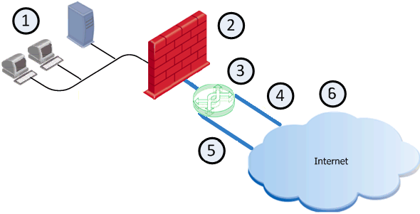

Example of a typical deployment with one dedicated physical interface for two ISP links
If only one external interface is available on the Security Gateway, you can configure two subnets on the same external interface.
(See the R80.20SP Quantum Maestro Gaia Administration Guide > Chapter Network Management > Section Network Interfaces > Section Aliases.)
Both ISP links are then connected to the same Security Gateway interface, but to different next hop routers, usually through a switch.
Item
Description
1
Internal network
2
3
Switch
4
ISP A
5
ISP B
6
Internet
