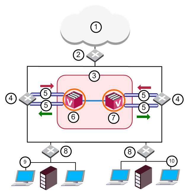

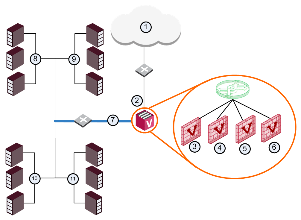

Core Network Security
Many Enterprise environments are based on core networks. Situated adjacent to core network backbone switches, VSX protects the internal network by providing security at layer-2, layer-3 or both. VSX communicates with the core network using the existing infrastructure. With Virtual Systems in the Bridge ModeClosed Security Gateway or Virtual System that works as a Layer 2 bridge device for easy deployment in an existing topology., VSX can protect departmental networks, while simultaneously preventing network segmentation. In this case, switches are located at the entrance to each department's network.
Item
Description
Item
Description
1
Internet
8
LAN Switches
2
Core Network Backbone switch
9
Sales
3
VSX ClusterClosed Two or more Security Gateways that work together in a redundant configuration - High Availability, or Load Sharing.
10
Finance
4
Router
Sync Network
5
VLAN
Physical Interface
6
Member 1
VLAN Trunk
7
Member 2
VSX ensures connectivity between the core network and the Internet or external networks, while providing perimeter security. Security can be configured on a per VLAN basis.

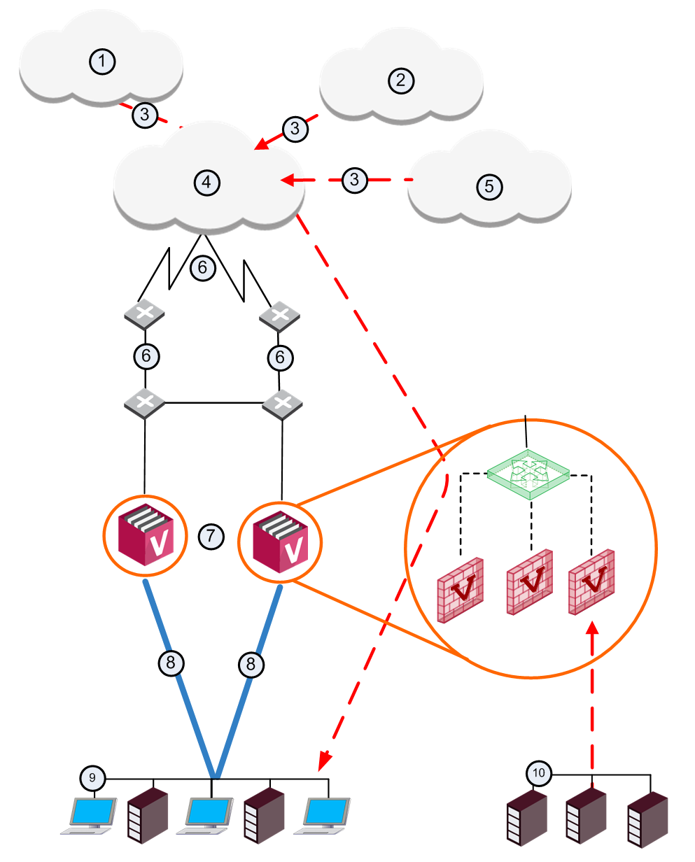

Dynamic Routing
Important - Virtual Routers are not supported (see Known Limitation 01413513).
In an enterprise network with dynamic routing protocols (OSPF/BGP), VSX secures the DMZ services, VPN peers, Domains and partner networks.
In this example, BGP neighbor updates in the routed core network are selectively redistributed to application networks. OSPF provides connectivity between Virtual Routers, Virtual Systems, the core network and application networks.
Item
Description
Item
Description
1
Internet
6
Partner Network
2
Virtual Routers
7
BGP
3
OSPF
8
OSPF 802.1q
4
Virtual Systems
9
BGP in Routed Core
5
Extranet
10
DMZ

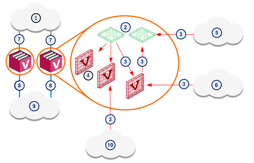

Perimeter Security
For example, security is enforced on each VLAN. The OSPF and BGP Dynamic routing protocols provide connectivity to multiple security zones along the perimeter.
Item
Description
Item
Description
1
Partner Access
6
BGP
2
Customers
7
VSX Cluster
3
IPsec tunnel
8
802.1q VLAN Trunk
4
Internet
9
Internal NetworkClosed Computers and resources protected by the Firewall and accessed by authenticated users.
5
Partner
10
DMZ

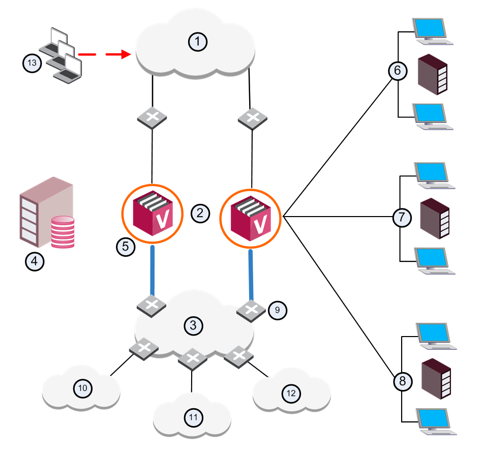

Managed Service Providers Using Multi-Domain Server
Managed service providers give connectivity and security services for Domain networks. Some of these Domains require remote access capabilities. In this service oriented environment, VSX and Multi-Domain ServerClosed Dedicated Check Point server that runs Check Point software to host virtual Security Management Servers called Domain Management Servers. Synonym: Multi-Domain Security Management Server. Acronym: MDS. provide central management and make connectivity and security easier, without affecting the existing IP topology.
In this scenario, a VSX Cluster is in a Point of Presence (POP) deployment for a service provider. VSX consolidates hardware for the service provider and ensures privacy and secure connectivity solutions (VPN) for users. This scenario is appropriate for High Availability and Virtual System Load SharingClosed VSX Cluster technology that assigns Virtual System traffic to different Active Cluster Members. Acronym: VSLS. cluster modes.
VSX and Multi-Domain Server provide a centralized, granular provisioning system for a number of Domains. Applications and services are separated by discrete Virtual Systems. Access to these services and applications is based on need.
Scenario:
Item
Description
1
Internet. Routers are between the VSX Cluster Members and the Internet.
2
VSX Cluster. One VSX Cluster MemberClosed Security Gateway that is part of a cluster. handles the Local Exchange, and another VSX Cluster Member handles server traffic of different Domains.
3
Core IP VPN Network.
4
Multi-Domain Server at the Network Operation Center monitors POP and connects to VSX GatewayClosed Physical server that hosts VSX virtual networks, including all Virtual Devices that provide the functionality of physical network devices. It holds at least one Virtual System, which is called VS0.. The Multi-Domain Log ServerClosed Dedicated Check Point server that runs Check Point software to store and process logs in a Multi-Domain Security Management environment. The Multi-Domain Log Server consists of Domain Log Servers that store and process logs from Security Gateways that are managed by the corresponding Domain Management Servers. Acronym: MDLS. in the NOC collects data for each Domain and stores the logs in separate private databases.
5
Multi-Domain Server at the NOC and the VSX Gateway make the Local Exchange.
6
Domain A web servers.
7
Domain B DMZ.
8
Domain C mail servers.
9
PE Router.
10, 11, 12
Domain A, B, and C. Each Domain manages its own security and cannot define Virtual Systems or other network components. Domains have secure VPN connectivity.
13
Remote access

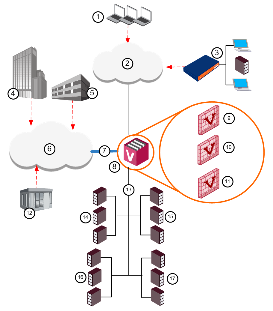

Data Centers
Data center providers supply external hosting services for Domain servers and databases. The service typically includes infrastructure, connectivity, and security for multiple Domains.
For example, you can have a scenario such as:
  • Multiple Domain networks sharing a common physical infrastructure.
  • Backbone that provides connectivity between each Domain and the data center.
  • Domain A connects to its web hosting servers.
  • Domain B connects to its mail servers.
  • Domain C connects to its database servers.
For cyber security and management, the data center provider deploys a VSX Gateway with one Virtual System for each Domain.
Item
Description
Item
Description
1
Remote Users
10
Virtual System for Customer A
2
Internet
11
Virtual System for Customer C
3
Remote network behind VPN-1 Edge
12
Customer C
4
Customer B
13
Data Center
5
Customer A
14
Customer A web servers each with separate VLAN ID
6
MPLS Backbone
15
Customer B mail servers
7
802.1q
16
Customer A Extranet
8
VSX Gateway
17
Customer C databases
9
This scenario offers a cost effective scalability solution for network expansion by means of remote connectivity. In this example, a VPN connection between a Domain Virtual System and a Check Point appliance that protects a remote network, integrates that network in the MPLS core. A Virtual System can give access to remote users who connect intermittently.
