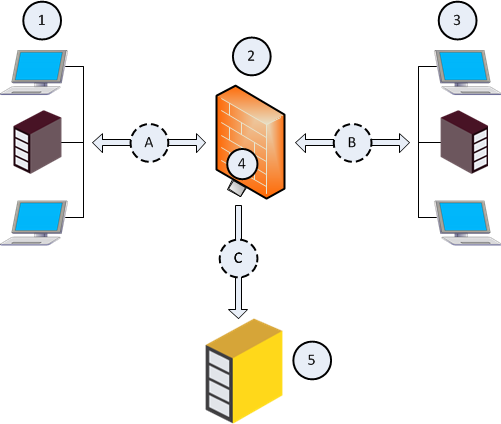

Example Topology and Traffic Flow:
Item
Description
1
First network that sends and receives traffic through the Security GroupClosed A logical group of Security Gateway Modules that provides Active/Active cluster functionality. A Security Group can contain one or more Security Gateway Modules. Security Groups work separately and independently from each other. To the production networks, a Security Group appears a single Security Gateway. (2).
2
Security Group, through which networks (1) and (3) send and receive their traffic.
3
Second network that sends and receives traffic through the Security Group (2).
4
Designated physical interface on the Security Group (2).
5
Recorder, or Packet-Broker that works in a monitor (promiscuous) mode.
A
Traffic flow between the first network (1) and the Security Group (2).
B
Traffic flow between the second network (3) and the Security Group (2).
C
Flow of the decrypted and mirrored traffic from the Security Group (2) to the Recorder, or Packet-Broker (5).
