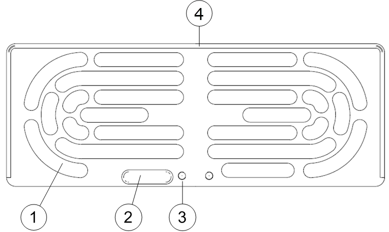

5 Field replaceable and hot swappable 100 VAC to 240 VAC Power Supply Units (PSUs) supply:
Each PSU is located on a tray that slides directly into the backplane.
The AC Power inlets are located in the rear of the Chassis. Each power supply has one power inlet.
Item
Description (AC Power Unit)
1
Air filter. Prevents dust entering the PSU.
2
Latch for extracting and inserting the PSU.
3
AC Power Supply LED
  • Green: AC Power is OK.
  • OFF: AC power is OFF
4
DC Power Supply LED
  • Green: DC Power is OK.
  • Red: DC power failure or Hot swap ready
5
Extraction handle for holding the PSU during extraction and insertion
