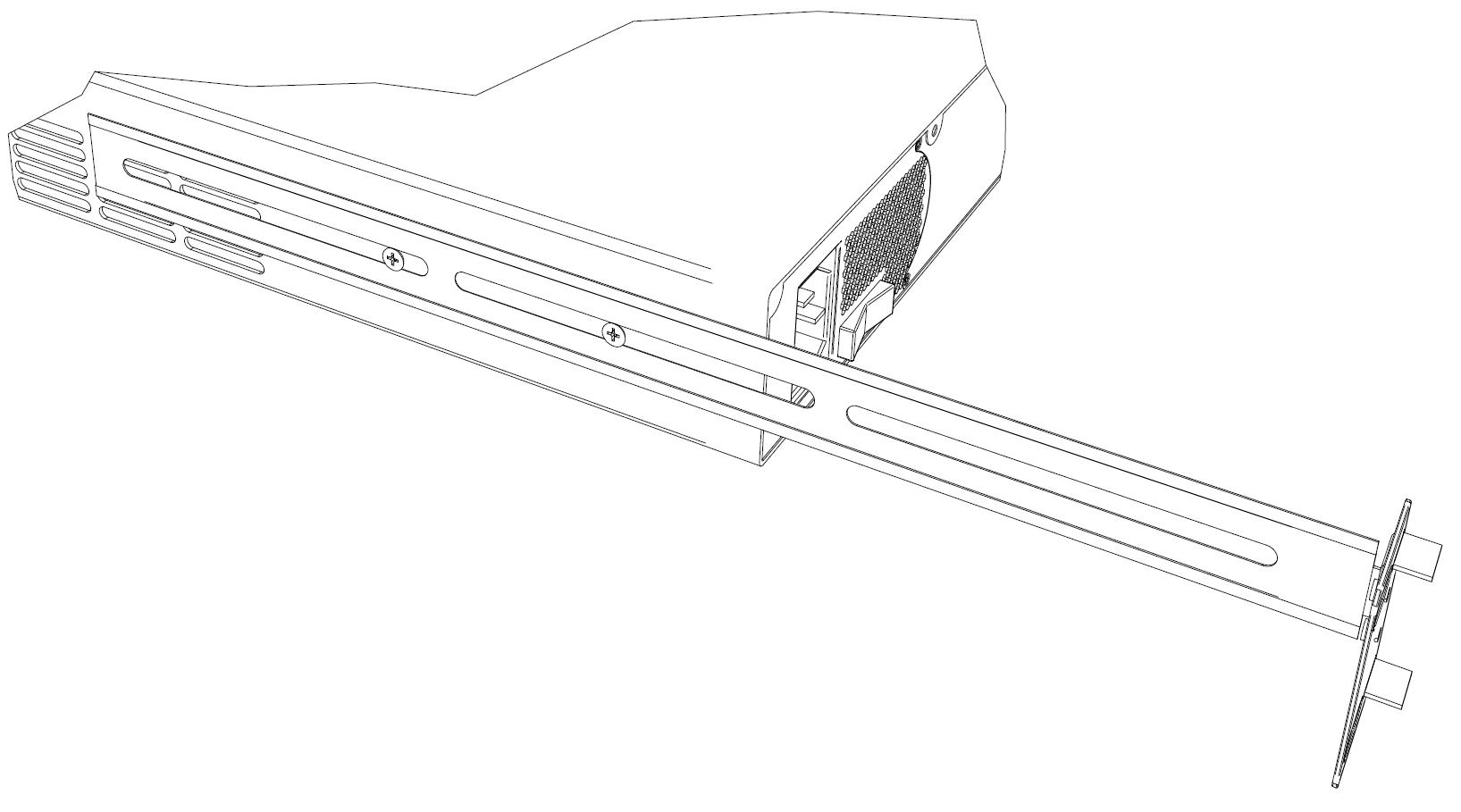

Fixed Rails
This section describes how to mount the appliance in a rack with fixed rails.
Important - We recommend that at least two people install the appliance in a rack to prevent injury, or damage to the appliance.
Rack Mounting Hardware and Tools
You must install rack mounting hardware on the appliance before you mount it in a rack. These rack mounting components are included in the kit.
Item
Hardware Description
Qty.
Use
Label
1
Ear mount bracket
2
Attaches to the appliance front panel. Both ear mount brackets are identical.
Assembly kit
Ear mount screws
12
Secures the ear mount brackets to the appliance front panel. These screw heads are smaller (5 mm).
Rack Ear Screw: 12pcs
2
Mounting bracket
2
Attaches to the appliance. Both mounting brackets are identical.
No label
3
Adapter
2
Attaches to the mounting brackets. Both adapters are identical.
Assembly kit
Mounting bracket screws
12
Secures the adapters to the mounting brackets and the mounting brackets to the appliance. These screw heads are larger (8 mm).
Rack Bracket Screw: 12pcs
Rack Mounting Tools
Phillips PH2 screwdriver. A magnetic head is recommended to hold screws in place and retrieve dropped screws. A powered screwdriver is also useful.
Note - Screws to attach the ear mount brackets and rail plates to the rack are not included.
Attaching the Ear Mount Brackets to the Appliance
Attach the two ear mount brackets to the front of the appliance.
Note - The ear mount screws have 5 mm heads.
To attach the ear mount brackets to the appliance:
  1. Attach the appliance ear bracket to one side of the appliance using six ear mount screws.
  2. Do step 1 again for the other side of the appliance.

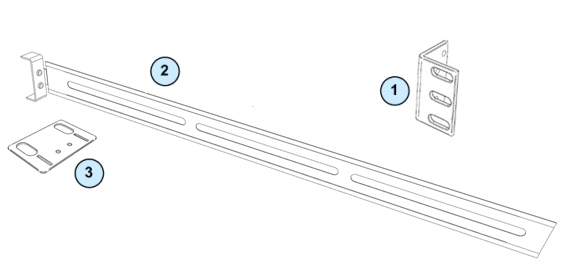

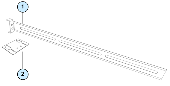

Attaching the Rail Plates
Attach the adapters to the mounting brackets to connect the appliance to the rear vertical rails of the rack.
Item
Description
1
Mounting bracket
2
Adapter
Note - The mounting bracket screws have 8 mm heads.
To attach the adapters:
  1. Attach an adapter to a mounting bracket using two mounting bracket screws.
  2. Do step 1 again for the other adapter and mounting bracket.

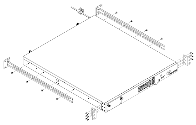

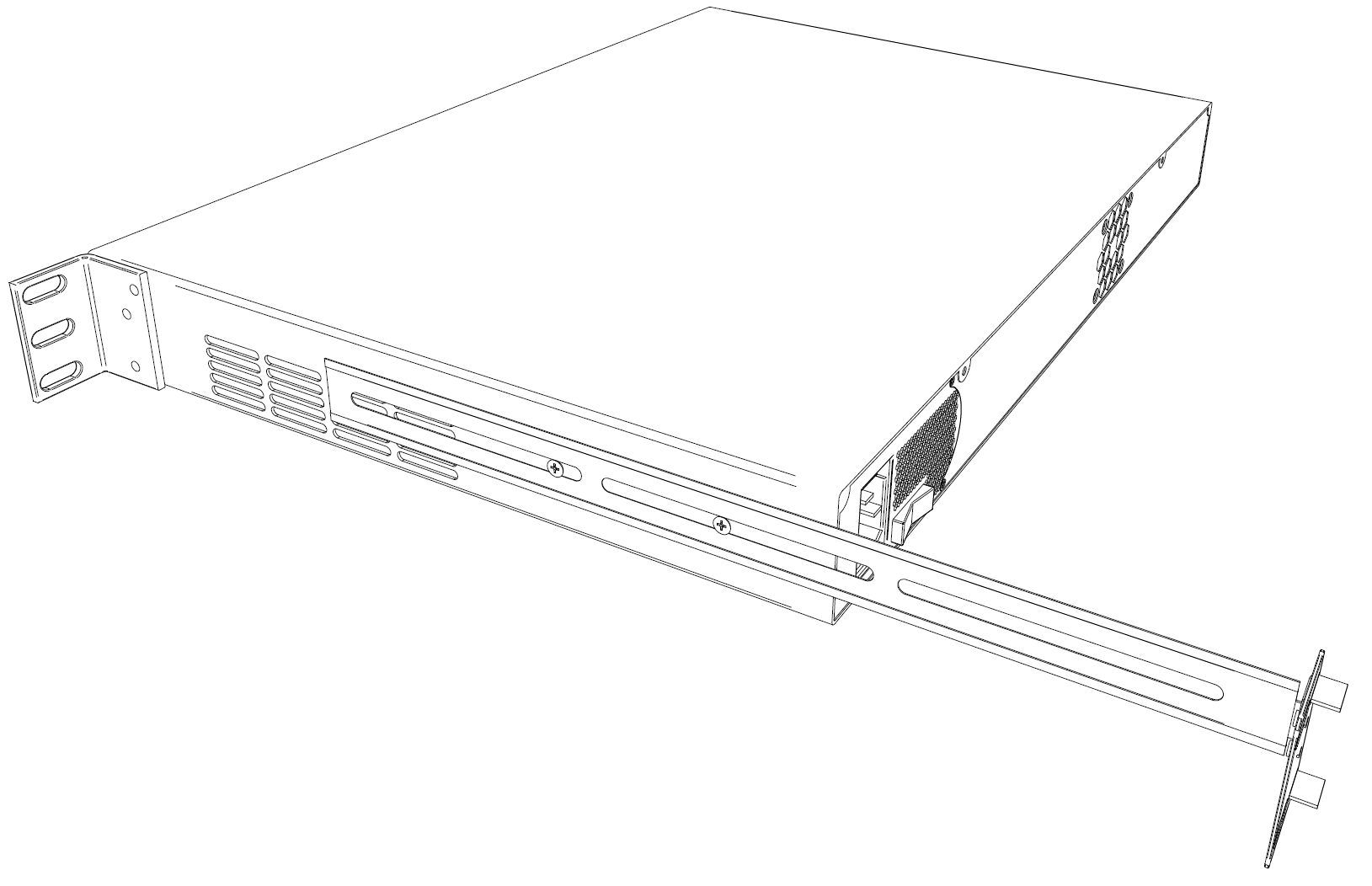

Attaching the Mounting Brackets to the Appliance
Attach the mounting brackets to the sides of the appliance. Align the adapters to connect the mounting brackets to the rear of the rack.
To attach the mounting brackets:
  1. Place the mounting bracket on the side of the appliance with the protruding side of the bracket facing away from the appliance.
  2. Attach the mounting bracket to the appliance using three mounting bracket screws.
  3. Do steps 1 and 2 again for the other side of the appliance.
Installing the Appliance in the Rack
Install the appliance in the rack. It may be necessary to adjust the mounting brackets to secure the appliance to the rack.
Important - Two people are required to install the appliance in a rack in order to prevent any possible damage.
To install the appliance in the rack:
  1. Attach the ear mount brackets to the front of the rack and attach the adapters to the rear of the rack.
  2. Confirm that the appliance is stable and secure in the rack.

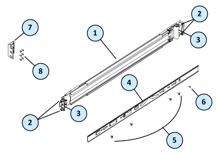

Telescopic Rails
Telescopic Rails Hardware
Item
Qty.
Use
Label
1
Outer rack rail section of the telescopic rail unit
2
Moves the appliance into position in the rack
No label
2
Square-hole rack screws
8
Come attached to the outer rack rails to be used with square holed racks
No label
2
Round-hole rack screws
8
For use with round-hole racks only.
Replace the original square- hole rack screws with the round-hole rack screws.
P/N for Round Hole 7.1 x8pcs
3
Rack mounting screws
4
At front of appliance - Attaches the ear mounts to the rack, which prevents movement of the appliance.
At back of appliance - Attaches the outer rack rail to the rack.
M5x20L x4PCS
4
Inner appliance rail section of the telescopic rail unit
2
Attaches to the sides of the appliance
No label
5
Appliance rail screws
8
Attaches the appliance rails to the appliance
#6-32 x8pcs
6
2
#6-32 x2pcs
7
Ear mount bracket **
2
Attaches the appliance to the rack
Assembly kit
8
Ear mount bracket screws**
12
Attaches the ear mounts to the appliance.
Rack Ear screw
** The ear mount bracket and screws are delivered as accessories together with the appliance.
Rack Mounting Tools
We recommend that you use a Phillips PH2 screwdriver with a magnetic head to hold and retrieve screws.
Installation Overview
Telescopic rails installation includes these procedures:
  • Attaching the inner rails to the appliance
  • Attaching the ear mounts to the appliance
  • Attaching round-hole rack screws (if you are using round-hole racks)
  • Attaching the outer rack rails to the rack
  • Installing the appliance in the rack

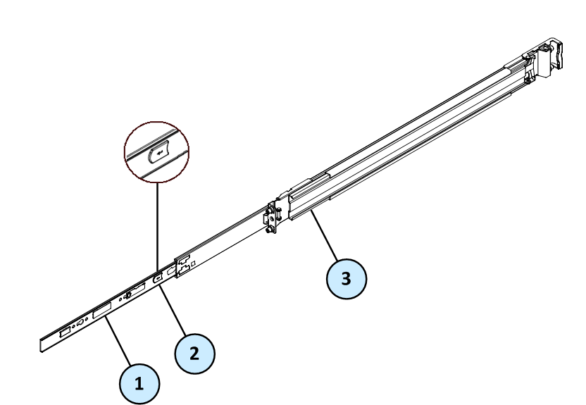

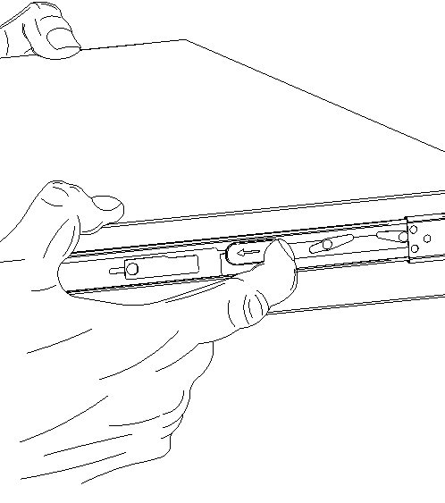

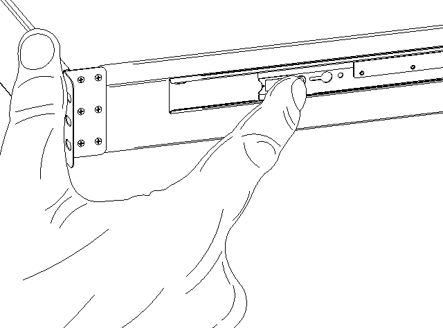

Attaching the Inner Appliance Rails
The outer rack rail section and the inner appliance rail section come as one unit when you open the box.
Before you can attach each appliance rail to the side of the appliance, you must remove the inner appliance rails from the outer rack rails.
To remove the inner appliance rail from the telescopic rail unit:
  1. Extend the inner appliance rail from the outer rail until the rails locks in place.
  2. Press the inner rail release latch, as shown, and pull the inner appliance rail straight out.
  3. Repeat steps 1 and 2 for the other telescopic rack rail unit.
Item
Description
1
Inner rack rail
2
Release latch
3
Outer appliance rail

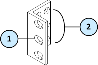

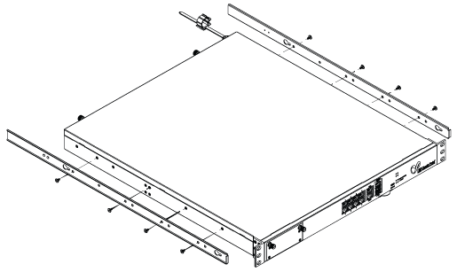

Attach the ear mounts to the left and right side of the front of the appliance to lock the appliance into the rack.
Item
Use
1
Rack post mounting hole for the rack mounting screws
When the screw is fastened, the appliance cannot be pulled out of the rack
2
Holes for ear mount bracket screws
Attaches the ear mount to the appliance
  1. Place the ear mount bracket on the side of the appliance near the front panel.
  2. Attach the ear mount bracket to the appliance using the six ear mount bracket screws.
  3. Do steps 1 - 2 again for the other side of the appliance.

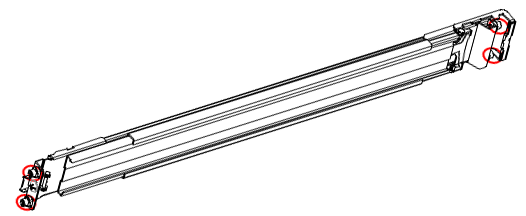

Preparing Round-Hole Rack Rails
If you use round-hole racks, you must replace the eight square-hole rack screws that come attached to the outer rack rails with the eight supplied round-hole rack screws.
Do this procedure before you attach the outer rack rails to the rack.
To attach the round-hole rack screws:
  1. Use a screwdriver to remove the square-hole rack screws from the front and back of the outer rack rail.
  2. Replace with four of the supplied round-hole rack screws.
  3. Do steps 1 - 2 again for the other outer rack rail.

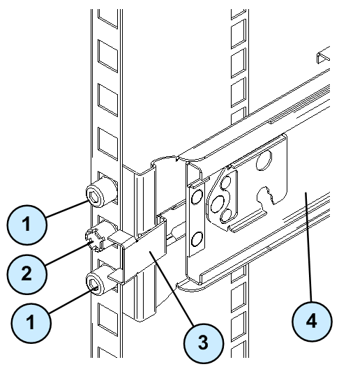

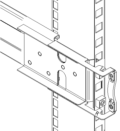

Attaching the Outer Rack Rails
Attach the outer rack rails to the rack. Make sure that you have the two rack rails ready.
Item
Description
1
Rack rail screws (attached to the end of the rack rail)
2
Screw hole with rack mounting screw
3
Securing clip
4
Rack rail
To attach the outer rails to the rack:
  1. If your rack has round holes, make sure to complete Preparing Round-Hole Rack Rails.
  2. Align the front end of the outer rail with the hole number.
    • Make sure that the securing clip faces the inner part of the rack.
  3. Gently pull forward and connect the outer rail to the rack by inserting the rack rail screws into the rack holes.
  4. Do steps 1 - 3 again to attach the rear end of the outer rail to the rack.
    The rear securing clips are marked with the letters R (for the right rack rail) and L (for the left rack rail).
  5. Use a rack mounting screw to secure the rear end of the outer rail to the rack.
  6. Do steps 1 - 5 again for the other outer rail.

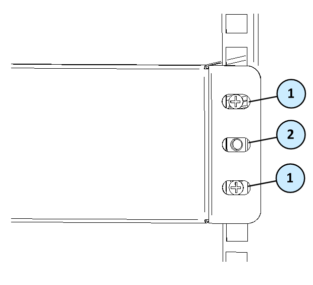

  5. For each ear mount, use a rack mount screw to secure it to the rack and make sure that the appliance cannot move. This disables the telescopic rails.
    Use the rack post mounting hole that is between the rack rail screws (see item 2 in the figure).
Item
Description
1
Rack rail screws attached to the outer rack rail
2
Rack post mounting hole for rack mount screw
