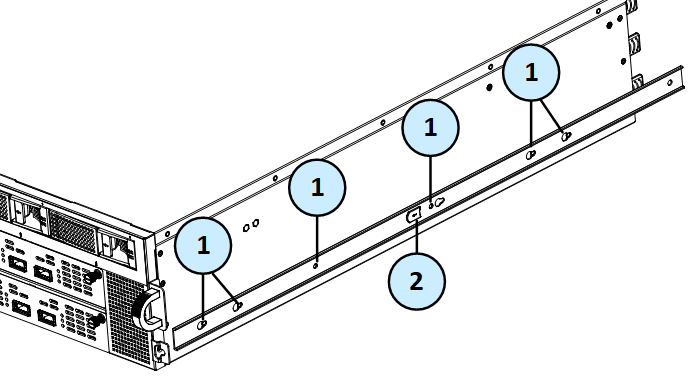

To install the inner appliance rails to the appliance:
  1. Place the appliance rail on the side of the appliance and make sure:
    • The release latch is facing away from the appliance
    • The arrow on the release latch points to the front of the appliance
    • The appliance rail is longer than the appliance
  2. Install the appliance rails to the side of the appliance with the six provided screws. Refer to the below appliance rail image.
    Note - Do not over-tighten the screws. Check Point recommends that you leave the rail mounting screws loose until the server is completely installed. This eases installation by preventing binding of the server in the rack.
  3. Do steps 1 and 2 again to install the appliance rail on the other side of the appliance.
    Legend
    Item
    Description
    1
    Appliance rail screws
    2
    Release latch (press this latch to remove the appliance from the rack)

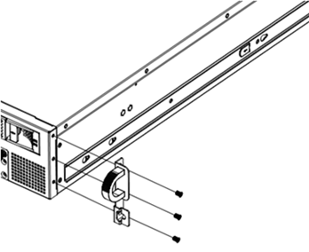

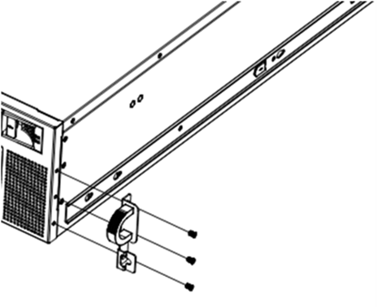

To attach the ear mounts to the appliance:
  1. Place the ear mount on the side of the appliance near the front panel.
  2. Attach the ear mount to the appliance with three ear bracket screws.
    • QLS250:
    • QLS450, QLS650, and QLS800:
  3. Do steps 1 - 2 again for the other side of the appliance.

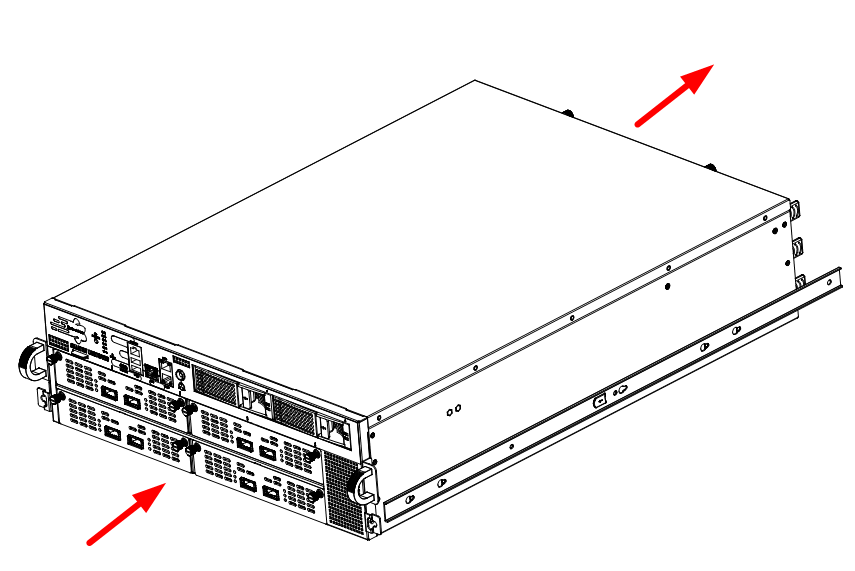

Appliance Air Vents
Make sure that the appliance air vents have sufficient airflow from front to rear when the appliance is mounted in a rack.
Important - If the appliance vents are blocked, the appliance can become too hot and it can be damaged.
The appliance and rack rails have been tested in extreme conditions and do not block air flow to the appliance.
These appliances are specifically designed to install with these rails.
The air flow in QLS250, QLS450, QLS650, QLS800 appliances (image shows the QLS800 model):
