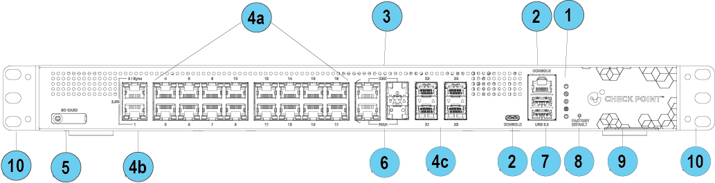

Front Panel
1900 / 2000 Appliance Front Panel
Note - There is only one set of LEDs. These LEDs show different colors depending on what activity is occurring. |
